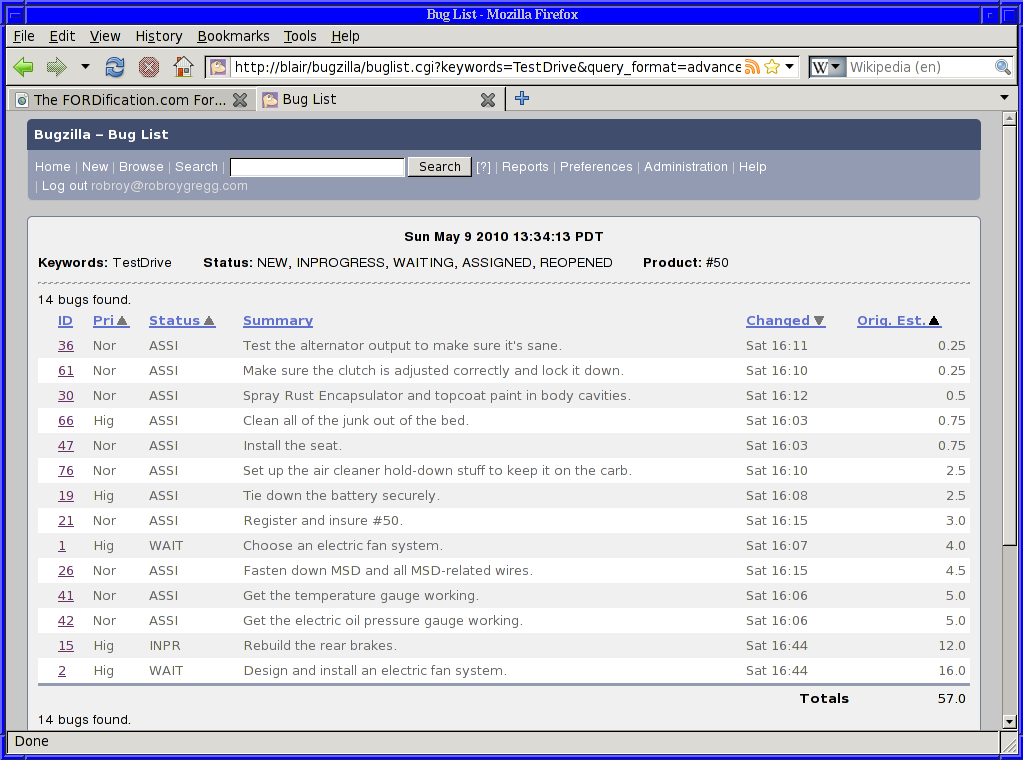

Computer programs often used to track software defects (bugs) can help us by remembering (and sometimes calculating) the answers to these types of questions:
- What things do I need to accomplish to reach my next project checkpoint, such as taking the truck for its first test drive?
- What's my current status on each one of those things, including any notes on that task that I've taken along the way?
- How long do I think each one of these tasks will take to complete? (The software will add them up for you and give you over-all time estimates).
- What are the dependencies between the tasks required to reach a checkpoint? (For instance, test-fitting an engine cannot be done until the motor mounts have been selected and installed.)
- What torque setting did I use on the bolts that hold my disc brake anchor arms to their spindles?
- What was the phone number of that place that made my custom motor mounts?

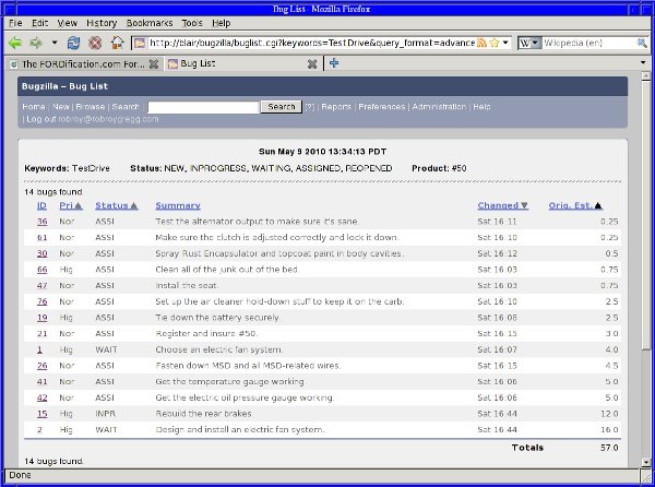

I'm using Bugzilla keywords to track the checkpoints; to see all of the "bugs" that need to be completed before the first test drive, I search for all "bugs" with the "TestDrive" keyword.
On a moment's notice Bugzilla can remind me of exactly what things I need to do, and the order I need to do them in, to reach my next checkpoint. It's also keeping track of my time estimates for each task and giving me a total, which allows me to have more realistic estimates of when I'll be reaching each stage.
Here's a screenshot that shows the list of things I need to do before taking #50 on its first real test-drive--you can click on this image to see it much more clearly.
