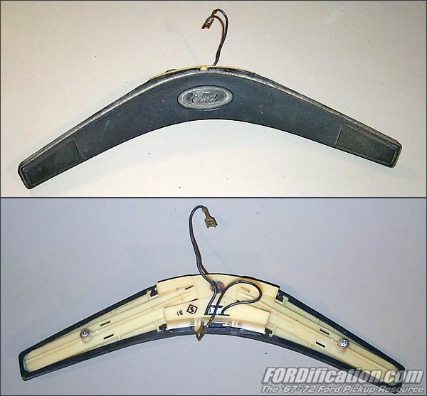

I'm betting the reason for the extra nub on the end of the '71-'72 shaft is for support for the plastic horn button assembly.
See the round discoloration on the backside of the plastic horn button assembly? IIRC, that's where the end of the shaft touches the plastic, since that's a fairly wide expanse of plastic there, and since people are going to be pushing on that plastic when they toot the horn, the extra nub on the end of the steering shaft helps keep it in one piece without breaking.

Good morning,
Looking at the great photo of the old style column and horn button that Keith posted, I'm now wondering what triggers the horn to sound. Does the horn sound when the horn button is pressed up against the end of the steering column?
Or is there another switch somewhere in the button that makes the horn work?
I just realized that if I cut a hole in the back of the button to make it go on, it might not contact the column at all any more, and if this is what makes the horn sound, I'll be out of luck.
Thanks very much for all the great advice folks,
-Robroy

there is a spring loaded brass doodad that makes contact with the underside of the horn ring causing the horn to honk. it's located in that round hole in the lower left of kieths "68-70" pic.
