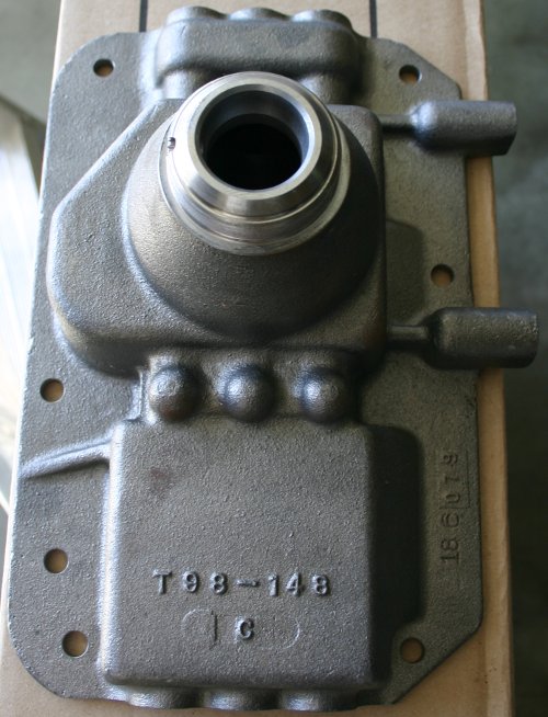

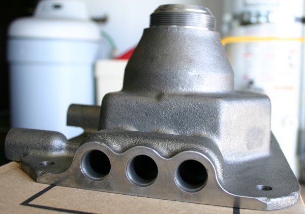

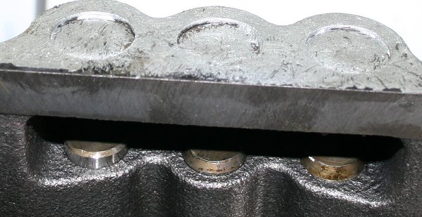

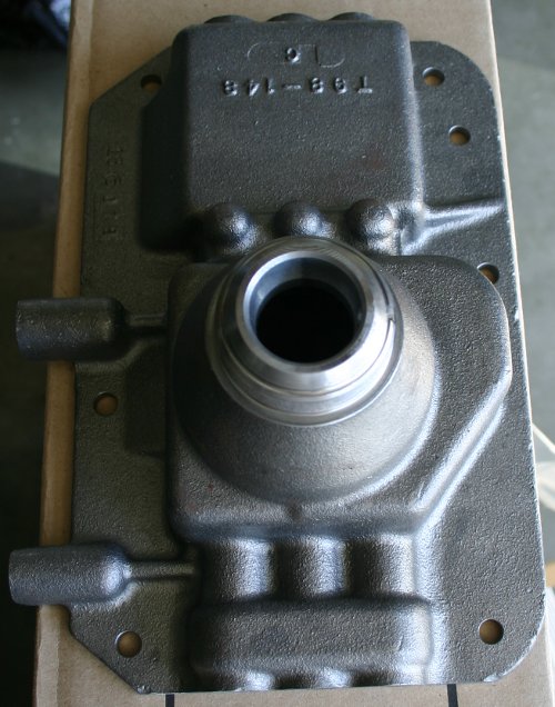

The top plate arrived and looks great!

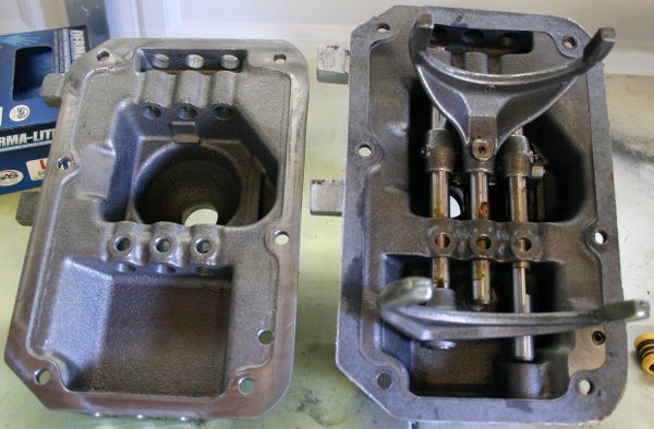

Here's the new plate:

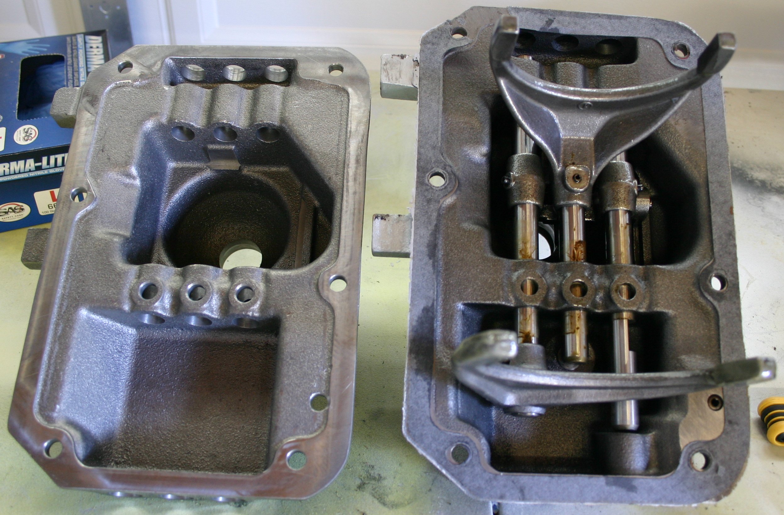

A comparison between the new and old plates in the socket area shows that as said by 70_F100, the old top plate had plenty of wear there! The new one's much tighter and smoother.

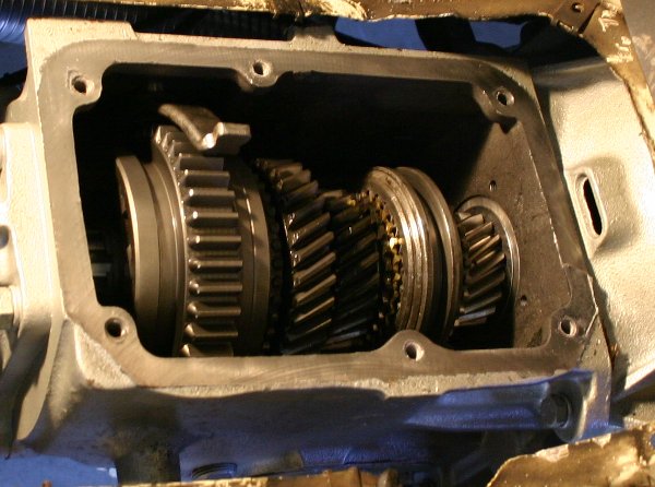

I bravely removed the old top plate! Of course, it helps my bravery a great deal to know that 70_F100 and other experts are here to answer all my questions!

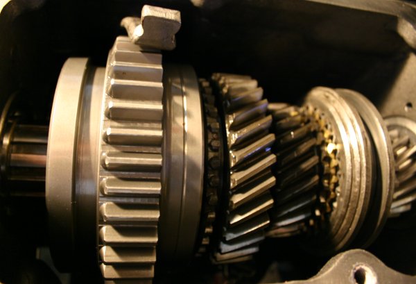

I could see the nice new gear the transmission guy installed (on the far left). The old one was seriously chewed up!
The top plate lifted off pretty easily, although I did feel like I was doing surgery on a robotic jelly fish! And here's the underside of the old top plate. Thankfully, it looks very clean and like the transmission guy did a good job of re-doing it. The dark stuff on the shifter shafts is grease, not rust (I was worried at first).

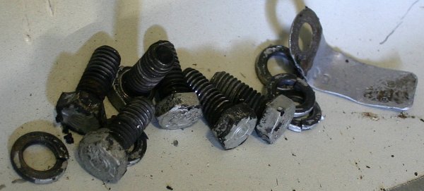

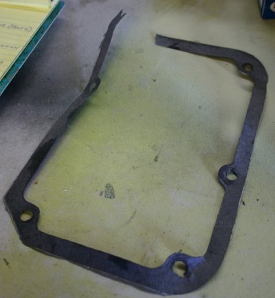

The gasket was very thin and tore when I took the top plate off.

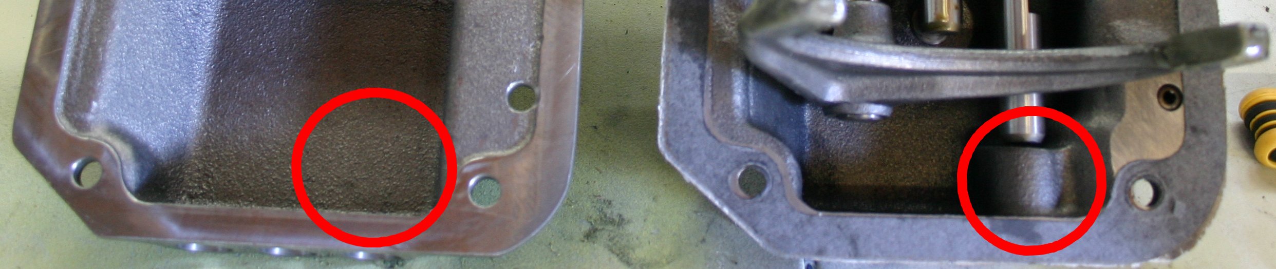

And here's the side-by-side comparison of the old (right) with the new (left). The link directly under the photo is to a full resolution version.

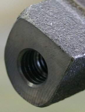

- I noticed that the two knobby extrusions normally on the passenger's side of the top plate were unfinished on my old plate, yet they're surfaced and have female threads in them on the new plate. What are these knobby extrusions for and why are the two plates different? The old one's on the left.
- One difference between the plates is a support/guide cylinder for the reverse shifter shaft in the old plate. The new plate has nothing in this area. Why do they differ in this way, and is this important? It looks like it'll work either way. The URL under the photo is a full resolution edition.

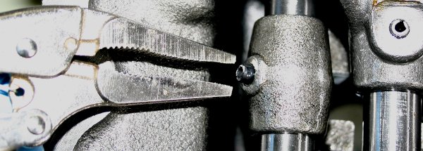

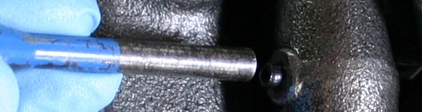

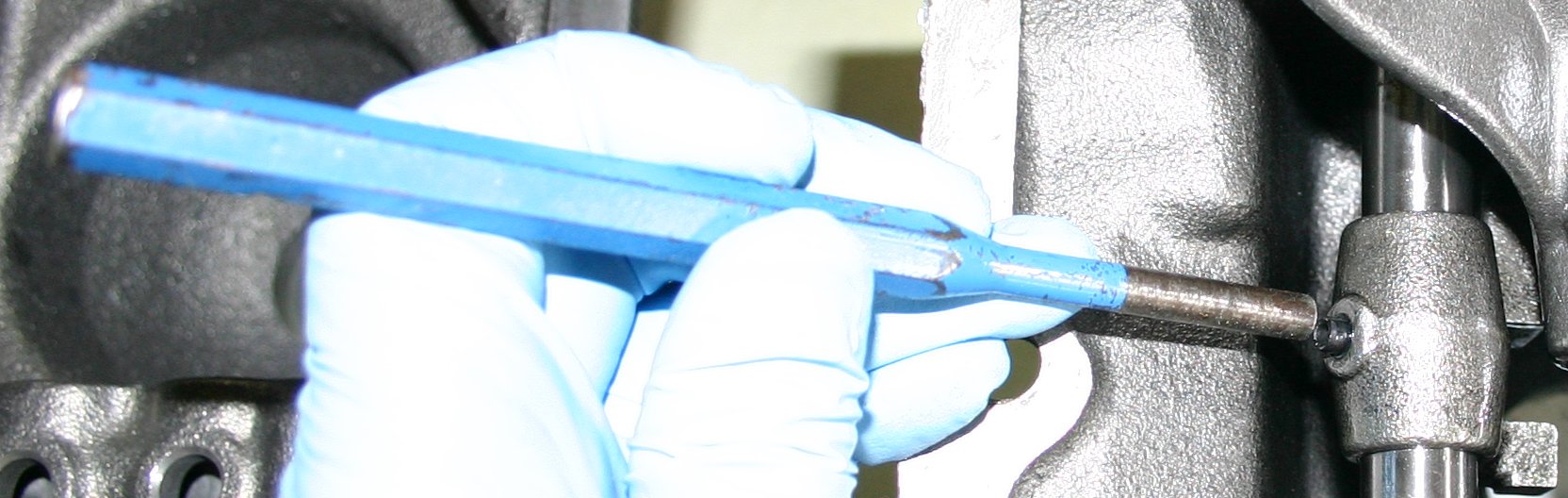

http://www.robroygregg.com/Number50/IMG_2928s2.JPG - How do I remove the roll pins? I'm not certain whether or not there's enough clearance behind where the pins exit to tap them through, so it looks like I might need to pull them out. Is this ever the case? A casual attempt with my vice grips yielded no results whatsoever, and I didn't want to chew up the roll pin with a more determined attempt.
Or should I punch them through to the other side, having faith that there will be room for them to make a complete exit?
- If I need to punch the roll pins through, is it true that I need a punch that's a smaller diameter than the hole the roll pin goes through? Sorry if this seems obvious, but I've never removed one of these pins before! The diameter of my current punch is greater than that of the hole. Here's a photo that shows the size difference more clearly.

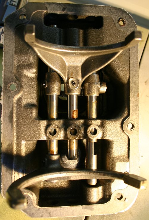

http://www.robroygregg.com/Number50/IMG_2943s.JPG - What's the best method to pop the expansion plugs out? Do I tap on them from the inside using a punch, forcing them towards the outside of the housing?

1) Since the T-18 was used in some larger trucks, the tapped holes in the bosses are probably for mounting a parking brake to the rear of the transmission.
2) I'm not entirely sure why that support was eliminated in the newer cover. The shaft is still supported in two places, so I wouldn't worry about it. It's reverse. You're not going to be doing any "gear banging" there.

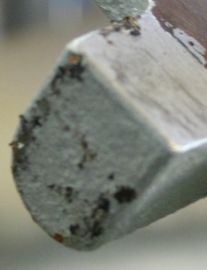

3) That's what your hammer and pin punch are for. Just drive the pins through. If you can't get them completely through, they should at least go far enough through to clear the shift rail. If that's the case, finish knocking them out once you have them on the workbench. You'll need to drive them back in from the bottom anyway.
4) That punch DEFINITELY won't work to get them out. You have to drive them completely through the shift rail, so the punch needs to be small enough to go through the hole, yet large enough that it doesn't go into the hole in the center of the rollpin. Driving them back in, the punch you have is perfect.
5) Once you remove the Shaft Lock Plunger (7233), you should be able to slide the shift rail far enough to the end of the cover to tap it lightly on the end, which will knock out the expansion plug for its respective bore. You actually don't have to remove the plug on both ends. The cover had to be made with both ends open to allow the align bore for the shift rails.

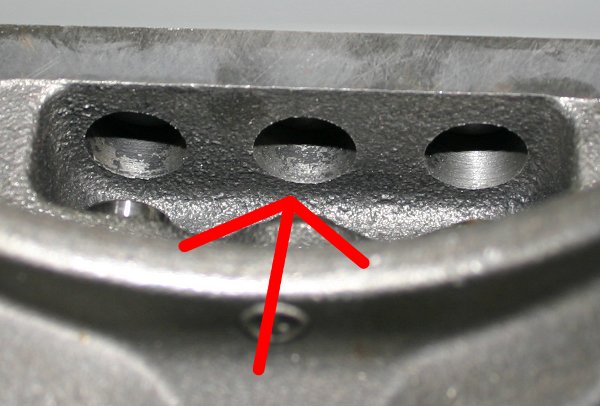

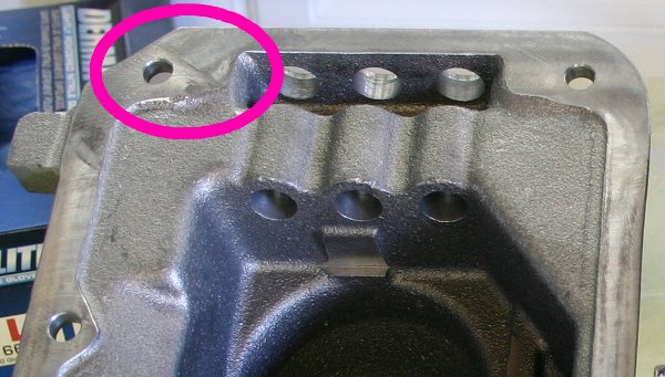

- Posts: 22330
Re: Making a T18 top end nice and tight: canes and top covers.
whats that crack in the new top?
- 70_F100
- Posts: 2999
- Joined: Mon Oct 22, 2007 11:23 am
- Location: North Carolina, Kernersville
Fordman, where do you see a crack?

Ah-ha, very interesting!70_F100 wrote:1) Since the T-18 was used in some larger trucks, the tapped holes in the bosses are probably for mounting a parking brake to the rear of the transmission.
Okay, I see what you mean. I won't worry about it!2) I'm not entirely sure why that support was eliminated in the newer cover. The shaft is still supported in two places, so I wouldn't worry about it. It's reverse. You're not going to be doing any "gear banging" there.
Understood! The part that really concerns me is the idea of getting those pins in from the bottom. Is it certain that I'll be unable to tap the pins in from the top instead? There's virtually no clearance under those shifter shafts to put a punch or hammer, and it doesn't look feasible to gain access to the area from the other side, through the cane hole.3) That's what your hammer and pin punch are for. Just drive the pins through. If you can't get them completely through, they should at least go far enough through to clear the shift rail. If that's the case, finish knocking them out once you have them on the workbench. You'll need to drive them back in from the bottom anyway.
Perfect, thanks! It's time to go shopping for a new punch or two then.4) That punch DEFINITELY won't work to get them out. You have to drive them completely through the shift rail, so the punch needs to be small enough to go through the hole, yet large enough that it doesn't go into the hole in the center of the rollpin. Driving them back in, the punch you have is perfect.
Okay, this is what I'll try!5) Once you remove the Shaft Lock Plunger (7233), you should be able to slide the shift rail far enough to the end of the cover to tap it lightly on the end, which will knock out the expansion plug for its respective bore. You actually don't have to remove the plug on both ends. The cover had to be made with both ends open to allow the align bore for the shift rails.

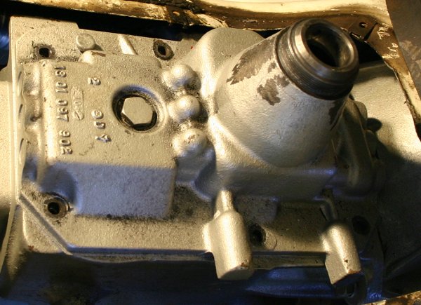

Hey Fordman! Is this what you're looking at?fordman wrote:whats that crack in the new top?
I looked at it up close and it looks like a scratch. There are a couple of them similar to it in other areas of that machined surface. But it sure looks like a crack in the photo!
Or is it something else?

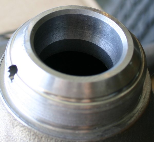

I made another discovery. The new top plate has a "cone" height on top that's made for a cane with a 3 and 1/8" shaft under the ball. My old top plate's made for a 3 and 1/2" cane! And both my old and new canes have 3 and 1/2" shafts on the end.
So if I want to use this new top plate (which I sure do!), I need a cane with a 3 and 1/8" bottom. Thankfully, it looks like Novak has them for $40, so this is a relatively painless discovery!
