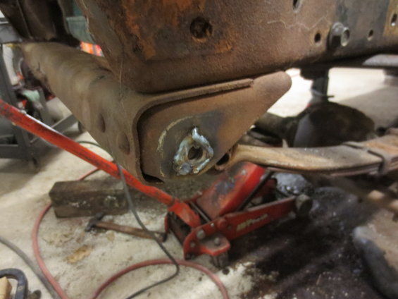

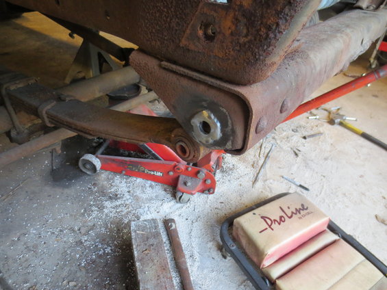

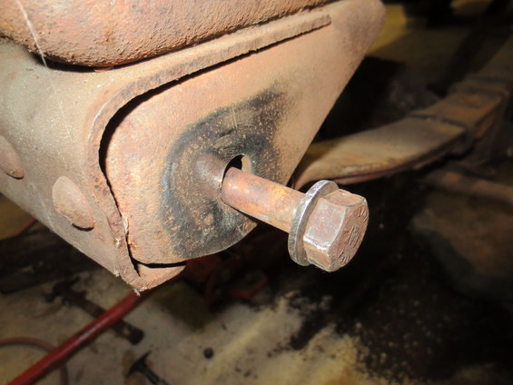

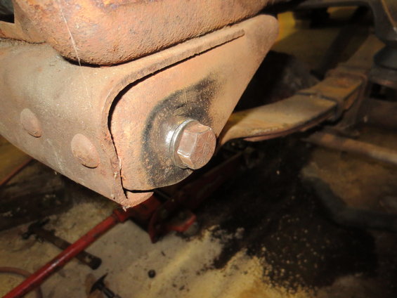

Thanks y'all i am not scared to death of it know its just going to take some welding wire and some other panels....
As for progress i forgot this update the front hanger. Still pondering adding a inch or so to the hanger but first i want to mock out stock height. The driver side front hanger was hammered. Bolt obviously was turning in the hanger and egged it bad.
Mocked it to the bottom of the slot where it was original. Heavy black oxide 9/16' washer.
How i had her held up to get it right.
Welded the washers on inside and outside then welded the inside up where it was egged. So metal filled in washers added to add strength via thickness.
End results...
Need to get some new springs the old ones are hammered. Then i can get a better idea of ride height... All for now.

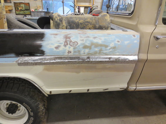

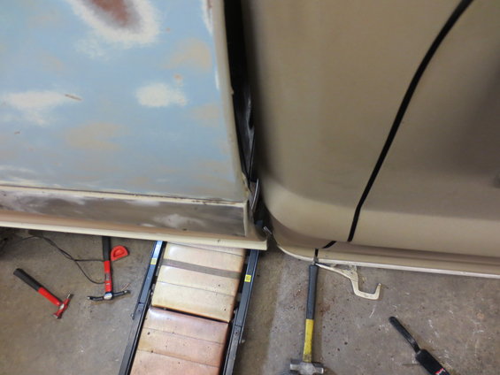

Here is my update from the first day the weekend when it was snowing. The bed I have is very solid but very crooked and does not have a tool box.. So....
Stripped it away gotta say the 3m pads are the best work well on air buffer.

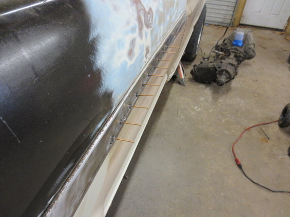

Another tool that works well is the Harbor freight stud gun. Two years or so various projects and been happy with it.

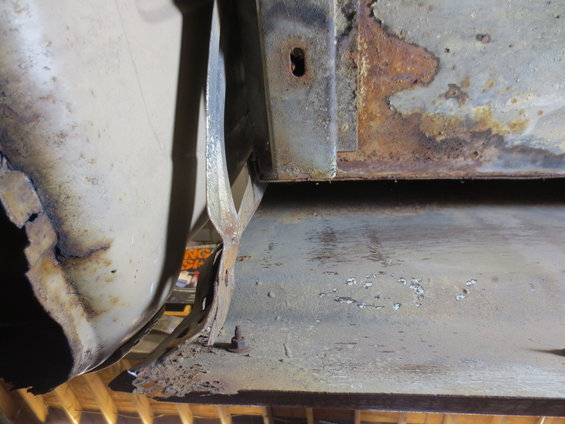

Had to make the bump look like a porcupine
Also had to beat I mean beat the lower braces back into shape to push the bottom out.
Gotta pull more on the bump yet but go the bed side right with the cab where I'm comfortable cutting it open to do the toolbox.
More on that later.
