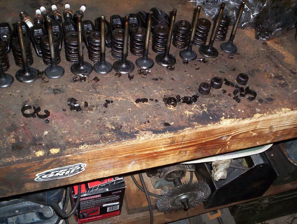

Well, the engine is completely disassembled and the block is ready to go to the machine shop. Hopefully I will get off in time on monday to drop it off. I took the head all apart so I can have them boil it before I clearance the intake valves and do the port and polish. I thought you all might get a kick out of my valve seals. This is how they were; I didn't bust anything taking it apart:

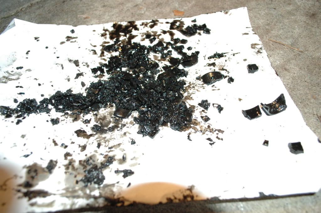

They were in a million pieces everywhere. It looks like it will need new rockers and at least exhaust valves being that they were pretty worn on the tips. One was worn enough that the rocker was hitting the spring retainer, and all the exhaust valves had to have the "lip" ground of the contact edge so I could slide them out without damaging the guides (which were nice and tight, probably from being well oiled
Also, just to let you all know I solved my piston problem. I am using 352 pistons and milling ~.050 off the tops, depending on what I get when I cc the head after I've done the clearancing. This will yield a cr of approximately 9.5:1 and have the extra strength of the 352 pistons full skirt. I learned over at fordsix.com that this is a pretty common thing to do.

Pshhh that's nothing! check out my valve seals
Anyways.. lookin' good, i can't wait to see this thing go back together and installed! I'm really interested on how this 6 cylinder will do in the crew 4x4

Well, don't get too ancy! At this rate it's going to be spring before I can get it in.1971ford wrote: lookin' good, i can't wait to see this thing go back together and installed! I'm really interested on how this 6 cylinder will do in the crew 4x4
BTW, you got me on the valve seals! Probably more in there since you have two extra cylinders...
