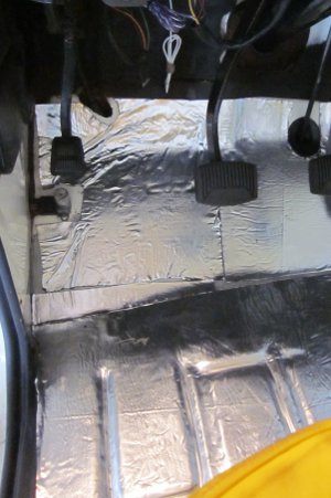

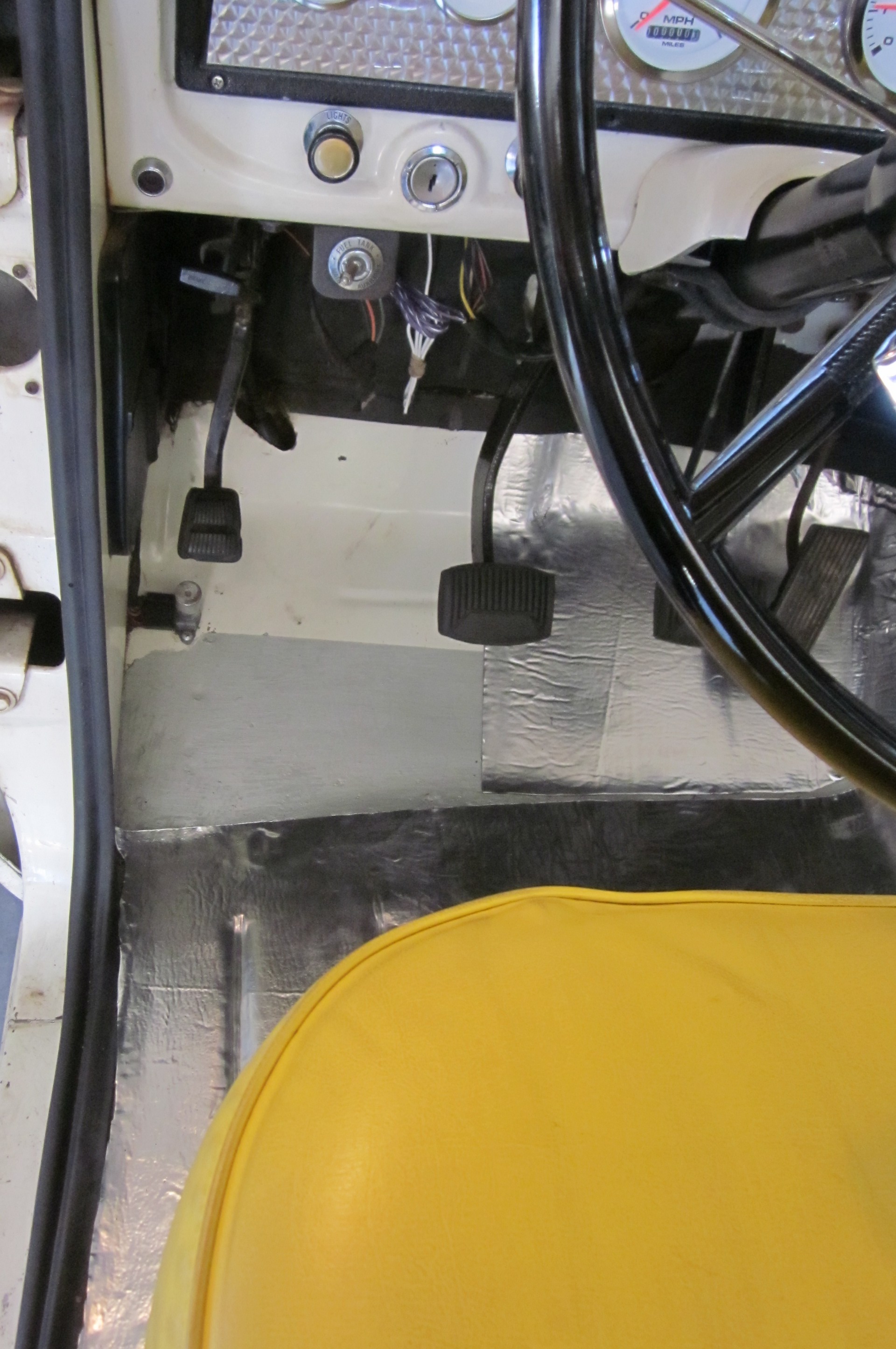

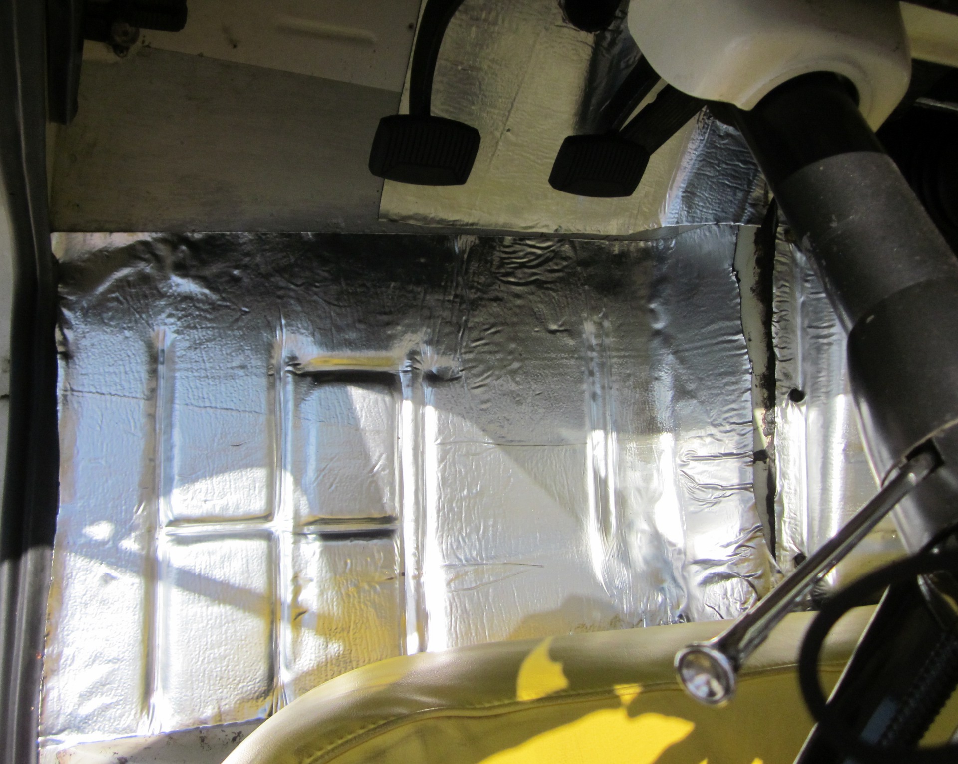

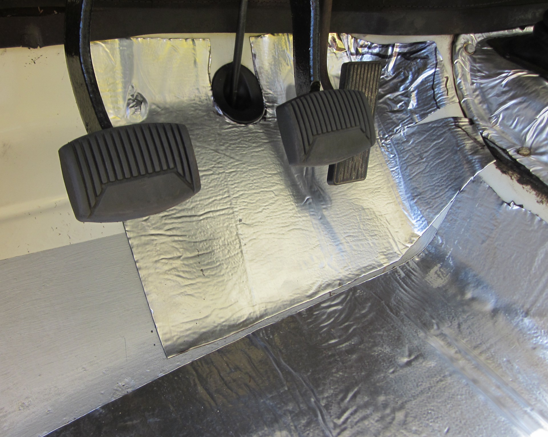

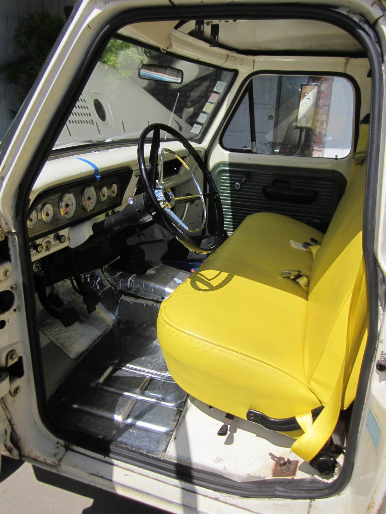

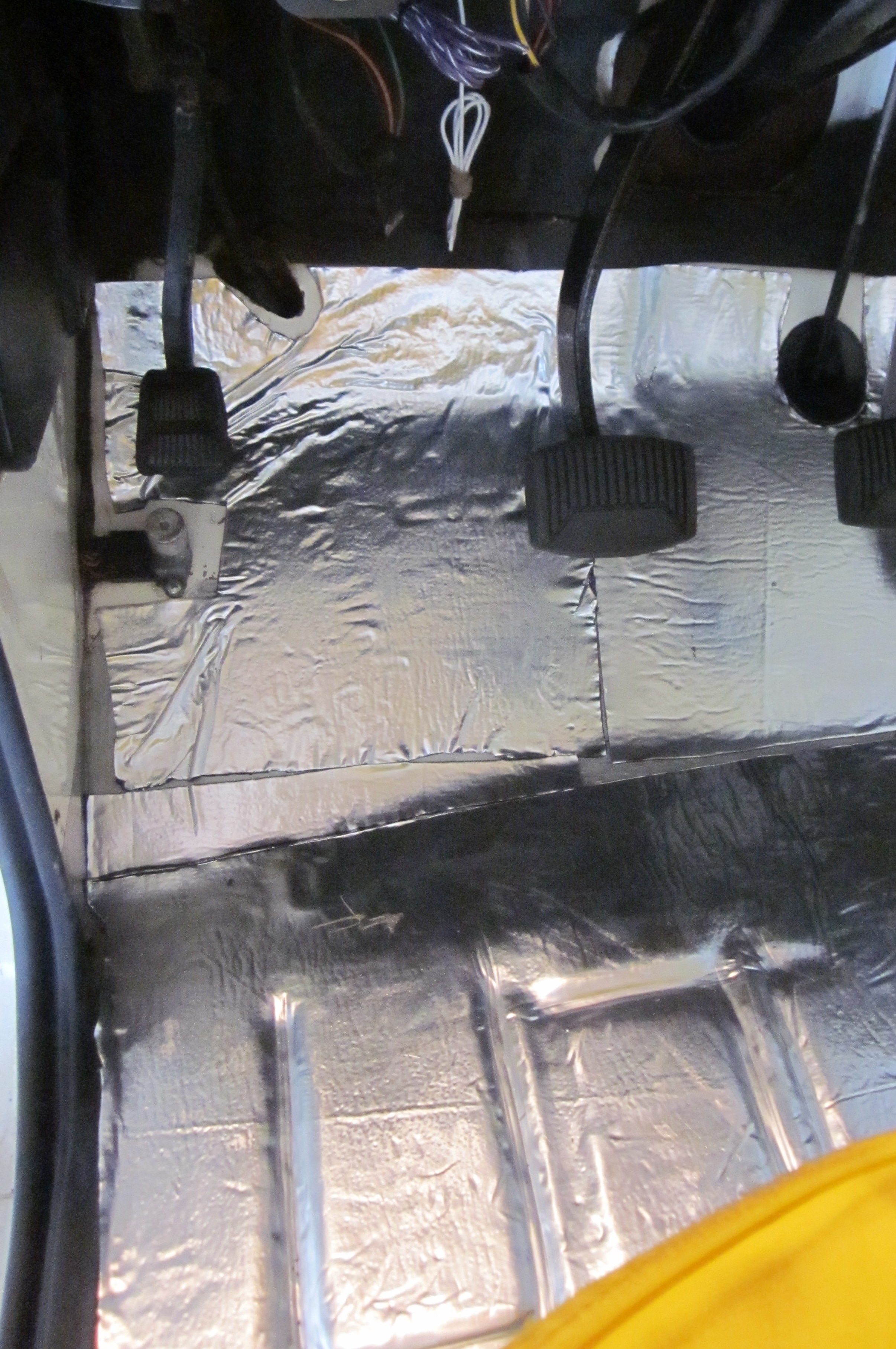

Today's Update:
Last Sunday I installed a little more Zilla Mat, this time on the driver's side. It was hard to cut it out to fit nicely around stuff there, since that's the complex side! But I'm starting to get used to this stuff a little bit, so it turned out better than I figured it would.
Still lots more to do, but it's fun to see it actually getting installed at least!

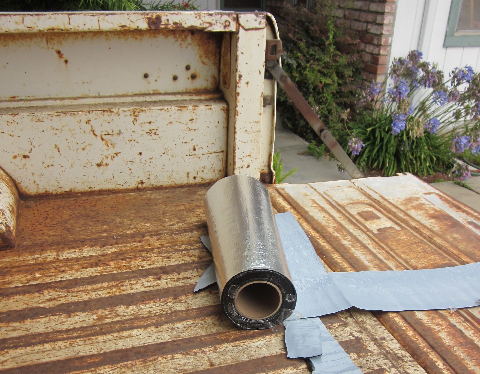

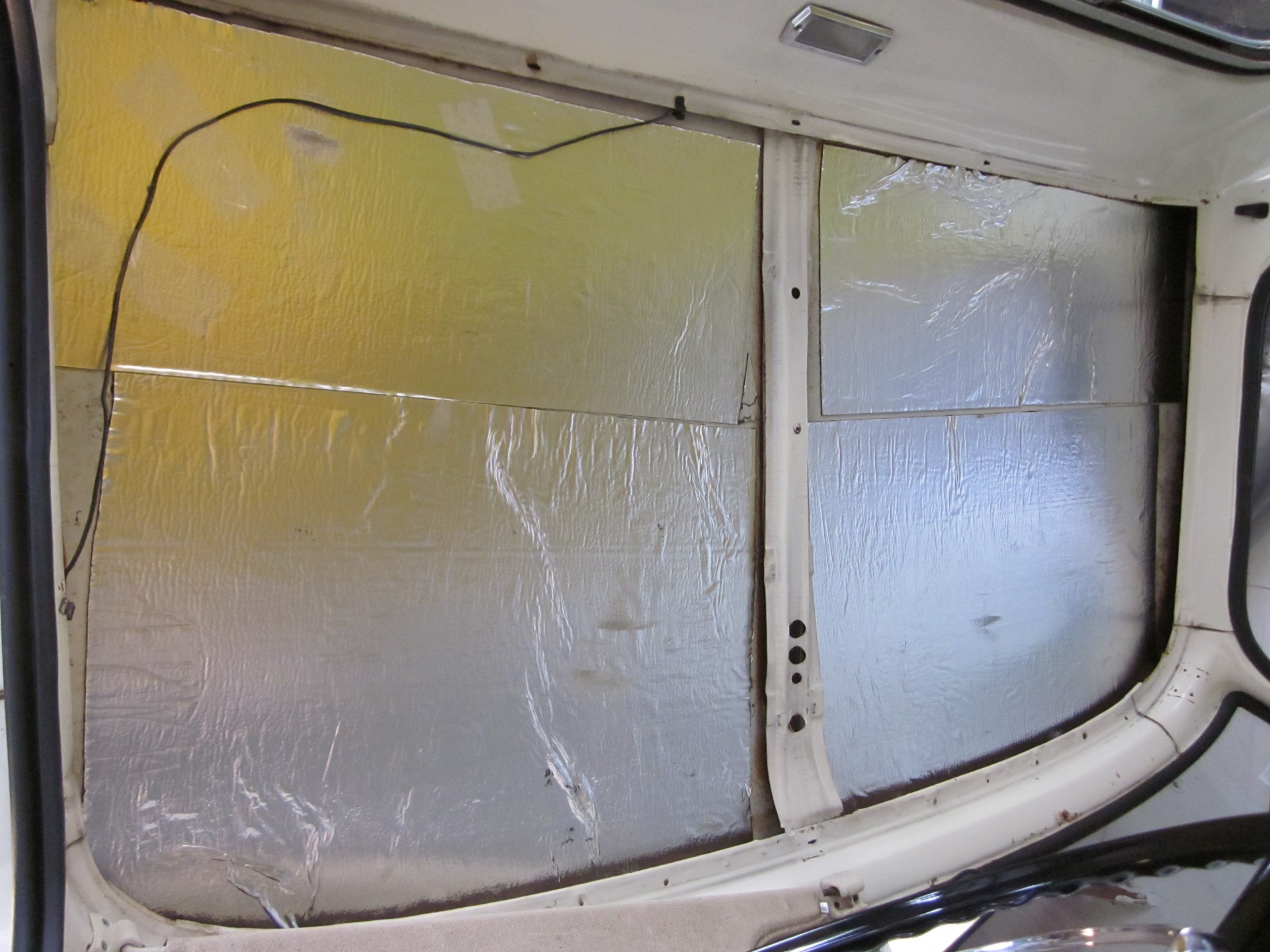

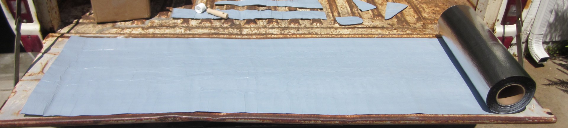

Today's Update:
Today I stretched the roll back out to warm up on the tailgate.
Then I covered the one remaining area:
I then stuck some slabs of this stuff up against the roof, and WOW did that make a difference! I haven't even driven the truck yet, but just tapping on the sheet metal makes the noise reduction pretty obvious. Once I install a head-liner it will probably be even better.
I still have a lot of the roll left! When I take the doors apart next I might lay some down on their insides.

As seems to be the case with many parts of this project, I just begin to get the hang of how to do something by the time I'm wrapping it up. Although I read it in the instructions, I doubted that leaving the protective sheet mostly ON, and just peeling away enough kind of anchor it where I wanted it to lay, would really be effective. Finally near the end I started doing this, and found that it's pretty easy to pull the protective sheeting away as I'm pressing the piece in to place--the protective sheeting doesn't get caught under the slab of Zilla Mat like I thought it might.
I've also gotten the idea that the main job Zilla Mat's doing is reinforcing sheet metal, to prevent it from vibrating. I'm starting to see how laying down a layer of more traditional, jute-based sound deadening material as you did would complement it well.
