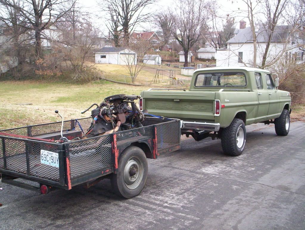

Well, I bought a motor. It's a 1975 with supposedly 133k miles on it. He had it all wired up and sitting in the frame so I could hear it run, which was nice. It fired right up, idled smooth as glass, and had no suspicious noises that I could hear so I plunked down the $150 and drug it home.
Took this when I pulled up.

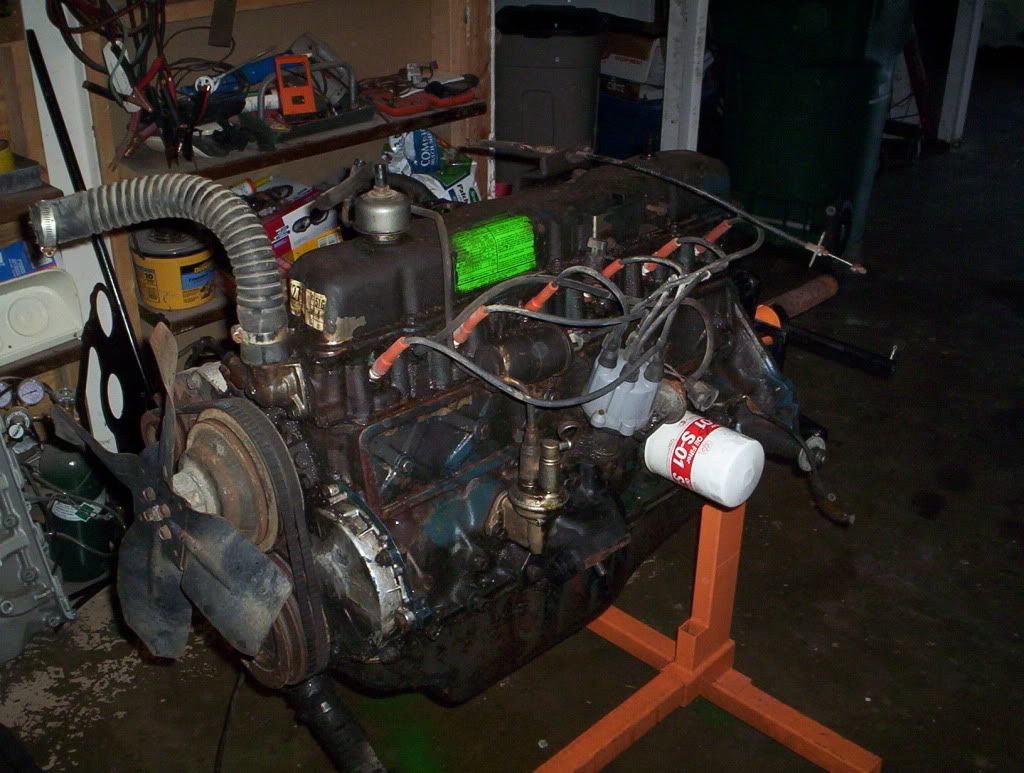

Got it on the stand after taking the trans off.
How it sits now!

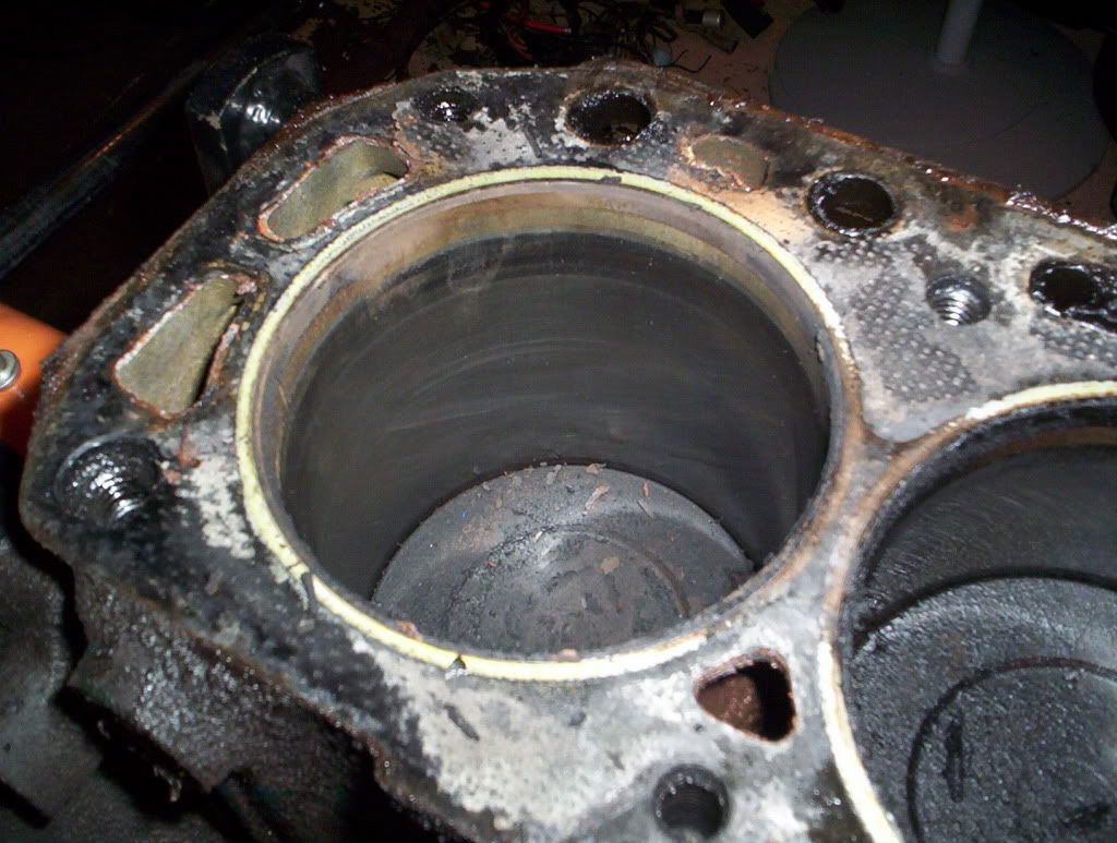

There is normal wear but almost zero ridge. Whomever owned it wasn't too good about changing oil or gaskets because it is filthy outside and a little gummed up inside, but not terrible. I can still see the crosshatch in the cylinders and there is barely any ridge, so I think a good hone will suffice. I'm going to pull the rest of it apart and clean everything real good so I can get a better idea of what I'm dealing with, but so far it's just filthy. Nothing a can of oven cleaner and the power washer can't take care of!
