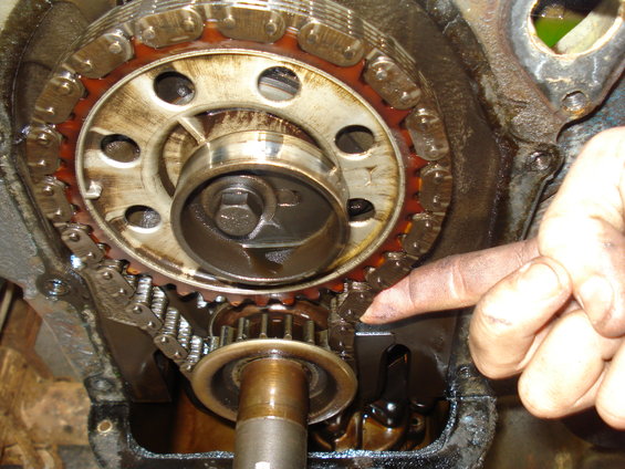

I found the old classic nylon teeth gears behind the front cover, and a pitted to death cam.

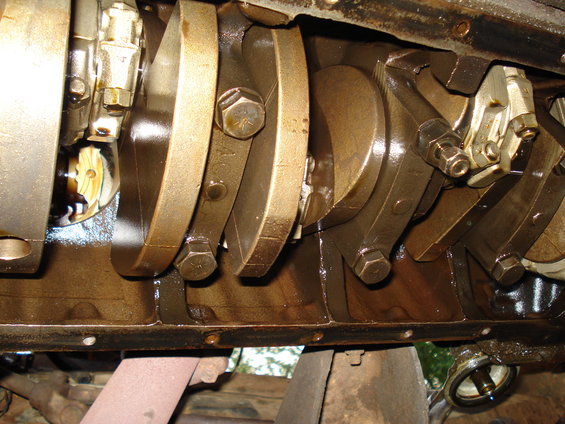

Pulling the pan, and a couple of caps revealed the bottom end was solid though cold still see corss hatching on the cylinder walls.

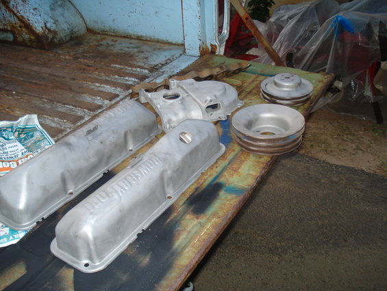

I took all the parts to work hot tanked them then threw them in the blast cabinet made aworld of difference.
Some paint makes it better.

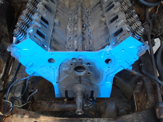

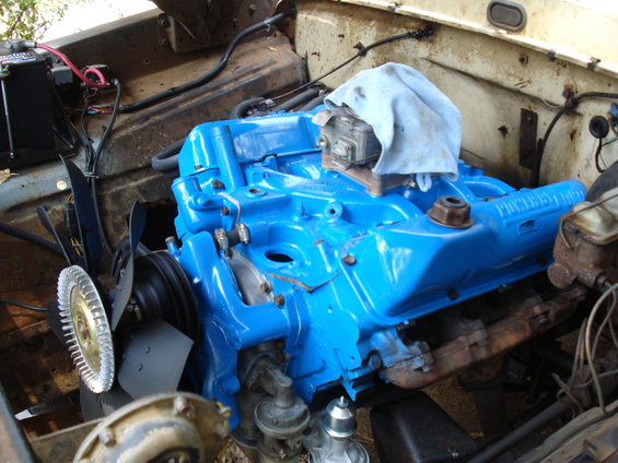

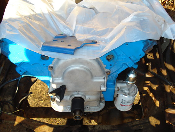

Got the block cleaned up, and painted.

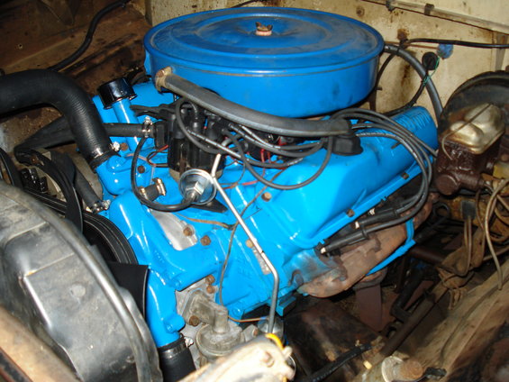

It now has a truck grind cam dynagear timing set, and of course new lifters.

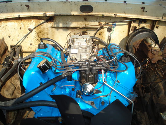

Here is a shot after the s code intake 4100 autolite witha the wood carb spacer, then a milodon high flow water pump fan, and clutch fuel pump, and balancer.
Got the pan back on don't worry the sides of the block will get cleaned when i've got the front clip off, and installing the headers.
Some tweaking made the linkage work out just fine.
Then a msd coil my pertronix dissy, and autolite wires, and plugs gives a stock style look.
Before the air cleaner mods while test driving. it ran so much better.

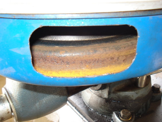

Now i wanted the air cleaner to look stock but be different so i pulled the snorkel welded the captured nuts up, and smoothed it down.

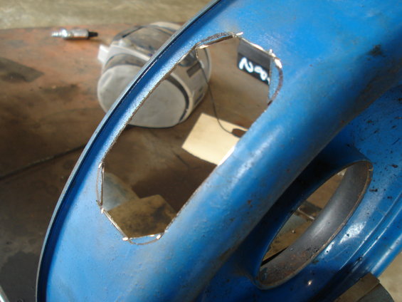

Then cut a template, and started cutting hole number two.
Little clean up.
Then it got sanblasted bondo on the lid paint work, and fatory decals. Check this out i love it. The look i wanted.
Little clean up.

I'm suprised that low rise intake works with your 360 heads.
Looks pretty sharp, I do like the dual cutout air cleaner-Looks like it could've come that way factory.
You will always see crosshatches in the cylinders looking up from the bottom. Cylinder bores only wear on the upper third or so of the bore.

eah the intake works well 360 ain't the super hot rod engine anyway.averagef250 wrote:I'm suprised that low rise intake works with your 360 heads.
The comment for the air cleaner yeah i wanted it to look like it could've been a factory piece so thanks!
For the bores maybe i should've specified i know what you talking about you can see the cross hatch were only the skirt hits but with the piston up at tdc the bores are smoothed from wear and running in but not like glass glazed where the rings ride towards the top f the bore. Sorry for not clarifying

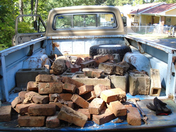

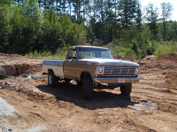

All righty well to test out the new engine how bout a load of brick.
The 360's still got that grunt. At a price of 10-11mpg. I unloaded at the old fill site.

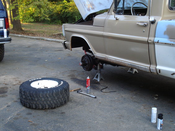

Then i repaired my damaged axle stud, and did some paint.

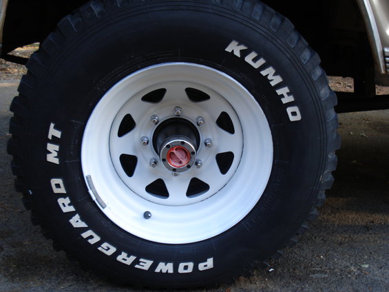

The rear wheels had been painted, an had new lug nuts so they just got a good bath.
then the front.
Alaina did this she ain't bad
Meanwhile i worked on the wheels and then installed them with new lugs up front nice.

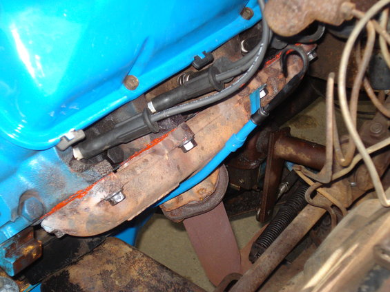

However the one thing i didn't pull off the motor blew a gasket. I got lucky though all the exhaust fasteners pulled out.
I cheated here.
The manifolds are shot they are so pitted i had to use some red rvt to get um quiet however there are a set of headers in this trucks future.
then the front.
I cheated here.

Manny, pulling a manifold back to change a gasket without dropping the pipe isn't cheating, it's wrenching.
Looking good

Yeah thats using the noggin i took one look at the collector studs, and went nope ain't gonna bust them off!AlleyCat wrote:Manny, pulling a manifold back to change a gasket without dropping the pipe isn't cheating, it's wrenching.Looking good
