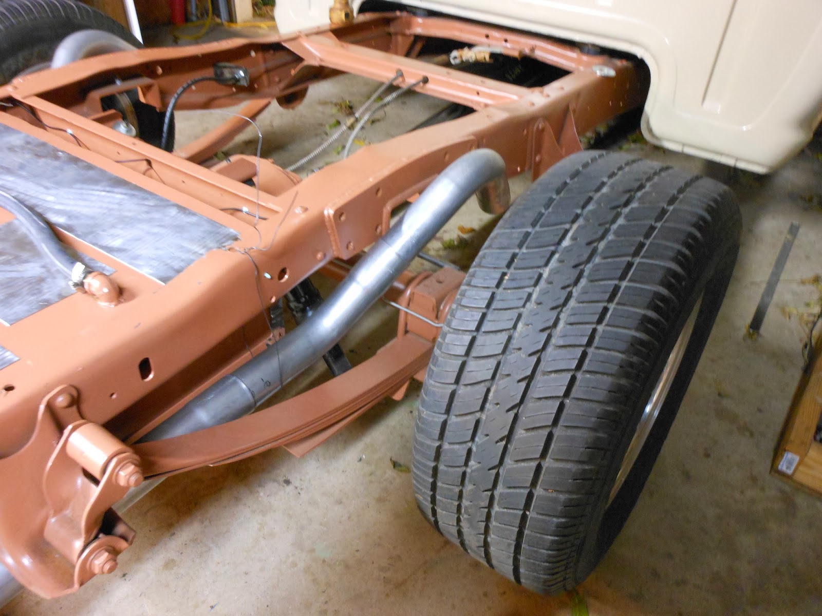

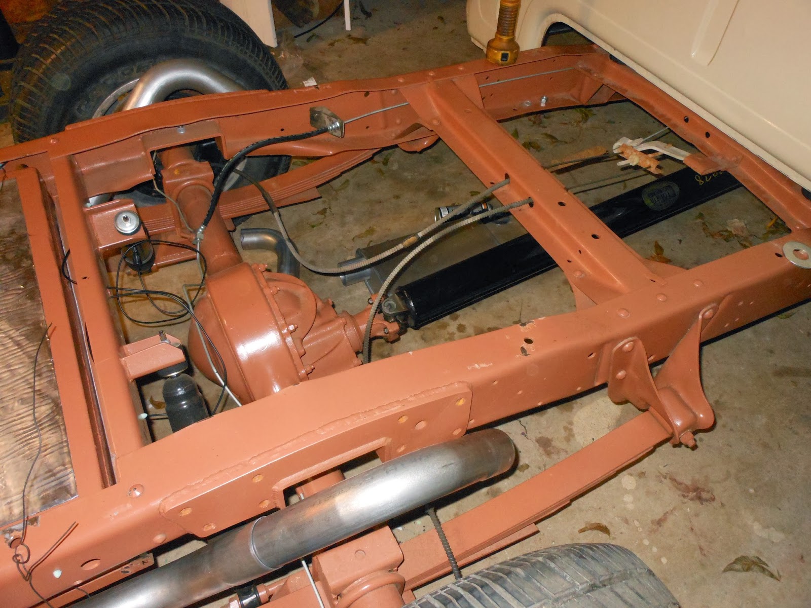

Got some stuff done. The exhaust is kicking my butt. The only way I have found to make it work out the back is to go outside the frame…

Thanks for that video, Pinch! Beautiful country. I've always wanted to go there. Interesting idea on the exhaust. I've never seen one run on the outside of the frame rail like that. Any concerns with spring travel bumping the pipes?

Oops! You probably weren't expecting a Gand Canyon Hike in July. I apologize for that. Some dumb a$$ copied the wrong link.sargentrs wrote:Thanks for that video, Pinch! Beautiful country. I've always wanted to go there. Interesting idea on the exhaust. I've never seen one run on the outside of the frame rail like that. Any concerns with spring travel bumping the pipes?
FYI - I am scraping the exhaust idea. It was a dumb idea and shame on that dumb a$$ too.

There are a couple of problems with my set up:
1. The Gas Tank - Can't run under it or between it and the rear end.
2. The Shocks - The custom shock mount I built are crossing through the area where one would normally route the exhaust. Plus I used air shocks, don't want to get to close to the bags.
3. Clearance - The space between the rear end, shocks and gas tank make it almost a zero chance of fitting anything in that area between the frame rails.
And now the biggest number of all
4. Risk - Routing it through the leaf springs and out side the frame rails could potentially be an endless battle of rattle and clearance issues. I plan on this truck to be a driver that can take long road trips with and doing a side exhaust will eliminate any risk of future problems. Not that I want the extra noise or like a side exhaust on my truck, but the potential of fewer problems over rules my WANTS.

You are just gonna have to run it out the sides.

You could always stop in front of the axle and add a turn down?

Many years ago I had it dumping under the bed. It turned the bed into a megaphone that came right back into the cab. Of course it was a 440 Chrysler speaking into the megaphone.sargentrs wrote:You could always stop in front of the axle and add a turn down?
