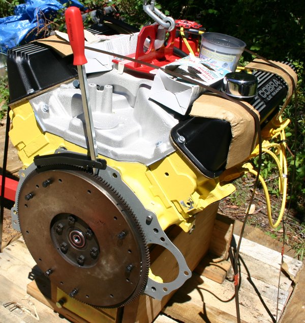

Hey Alvin! Thanks for your reply! Now that you mention it, one of the guys at an auto parts store mentioned the VW engine bracket.
Here's a photo of what I wound up using; it worked surprisingly well, and is also handy for turning the crank by grabbing the flywheel:
Thanks!
Thanks!

I almost bought one of those, a guy could turn the engine through the dust cover hole with one of those. :)
Why a guy would need to, I don't have any idea, just a guy could and that's good enough. LOL :)
What size engine is that again?
Cool looking pilot bearing you got there. ;)
Alvin in AZ
