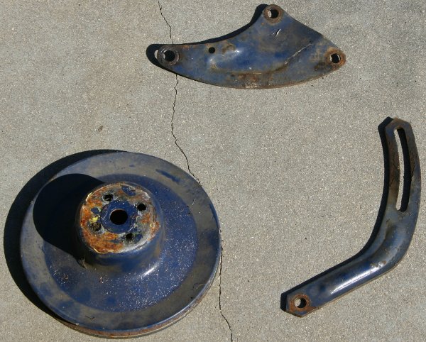

Here's my water pump pulley and some alternator brackets. Does anybody know of a source for chrome editions of these? I'd just like to save the bother of having to sandblast and re-finish them, and chrome ones would look nice after all.
Thanks very much!

the alternator brackets are the same as mustangs. they may make chorme ones for those.

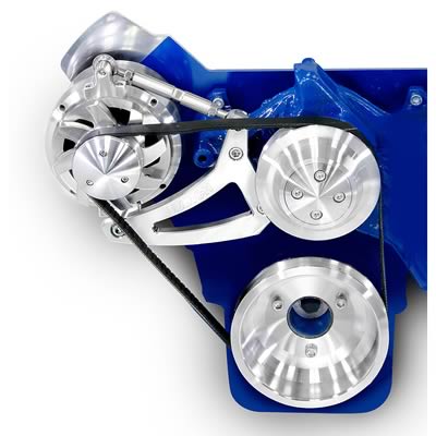

After looking in to this more, I now see that instead of $97 for a single V-belt pulley from March, and an extra $100 for the brackets from Hawaii Racing, I can go serpentine /with/ the brackets for about $370. That might be a better deal since the serpentine belt would be more reliable and would make it easier to put a 3G alternator in (I'm under the impression that most/all of those have serpentine pulleys).
Here's the kit I'm looking at (19020):

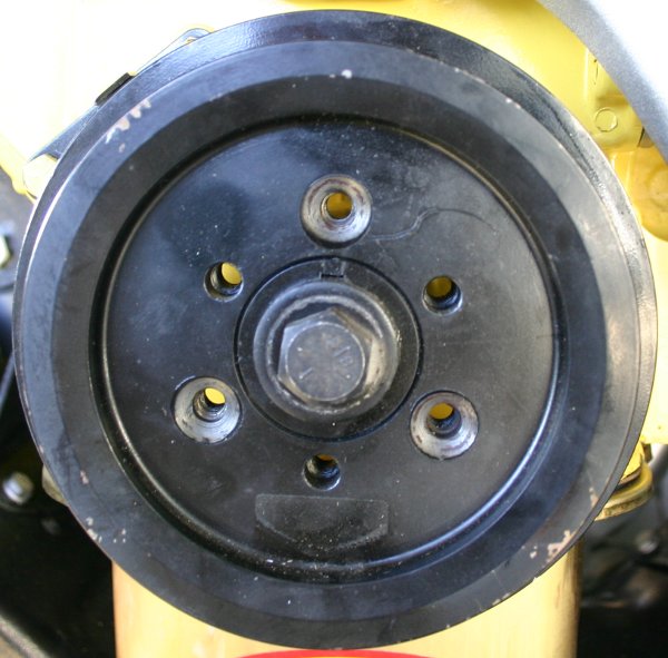

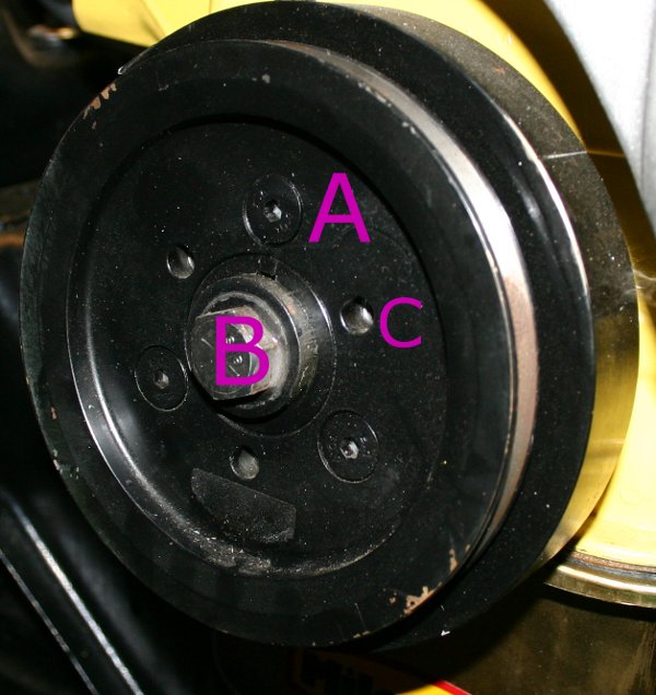

In order to apply March 19020 to my engine, I'll need to understand how the currently V-belt crankshaft pulley comes off. If this a simple deal?
Do I just unscrew the "A" bolts, leaving "B" completely alone? And are the "C" holes designed to work with a puller tool of some kind to lift the pulley off? I am correct in thinking that this pulley's separate from the harmonic balancer, right?
Thanks very much!

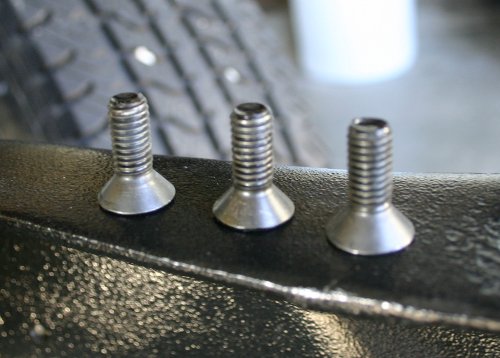

So the countersunk, allen-head screws in the holes marked "A" in the photo above are out--they came out pretty easily!
But the pulley won't come off easily. It's pretty snug on there.
Does anybody happen to know whether the pulley should pull off now? Do I need to use a puller tool on it? Or does that big bolt in the center need to come loose?
I'm avoiding touching the bolt in the center because I think that's the one that holds the harmonic balancer to the crankshaft.
Thanks very much for the advice!

Don't want to "bust your bubble", but that's not a serpentine setup.
That's nothing but a multi-groove belt setup.
It may be a BIT more reliable, and it looks pretty, but if you're doing the swap for functionality, you're pretty much wasting your time and money.

right. just because it doesn't have five or more pulleys doesn't mean it's not a serpentine . It is a 6-groove serpentine belt.
As for the pulley coming off yours, just needs persuasion. It's a interference fit.
