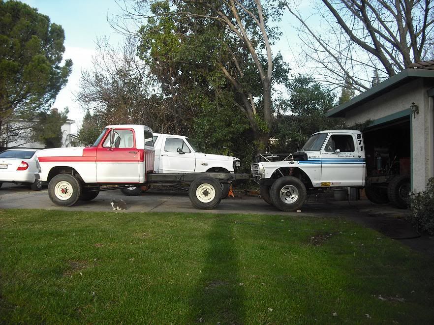

Bed off (pulled it off by myself, with no hoists/jacks, i'm proud
Mustang tank in (trying not to post too many pictures, as this is suppose to be about a flatbed)
Now I wait for my 2x4 to come in.
