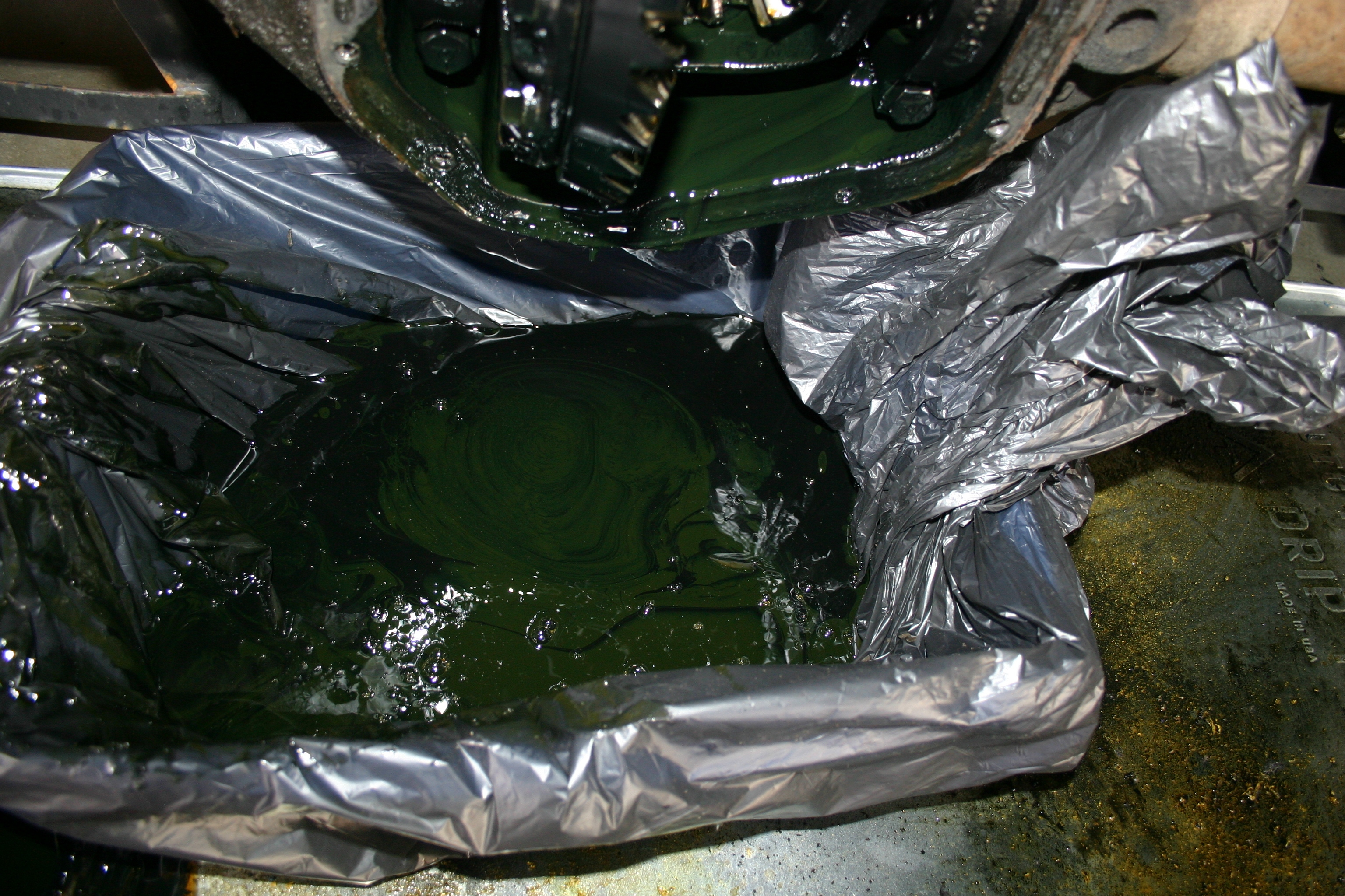

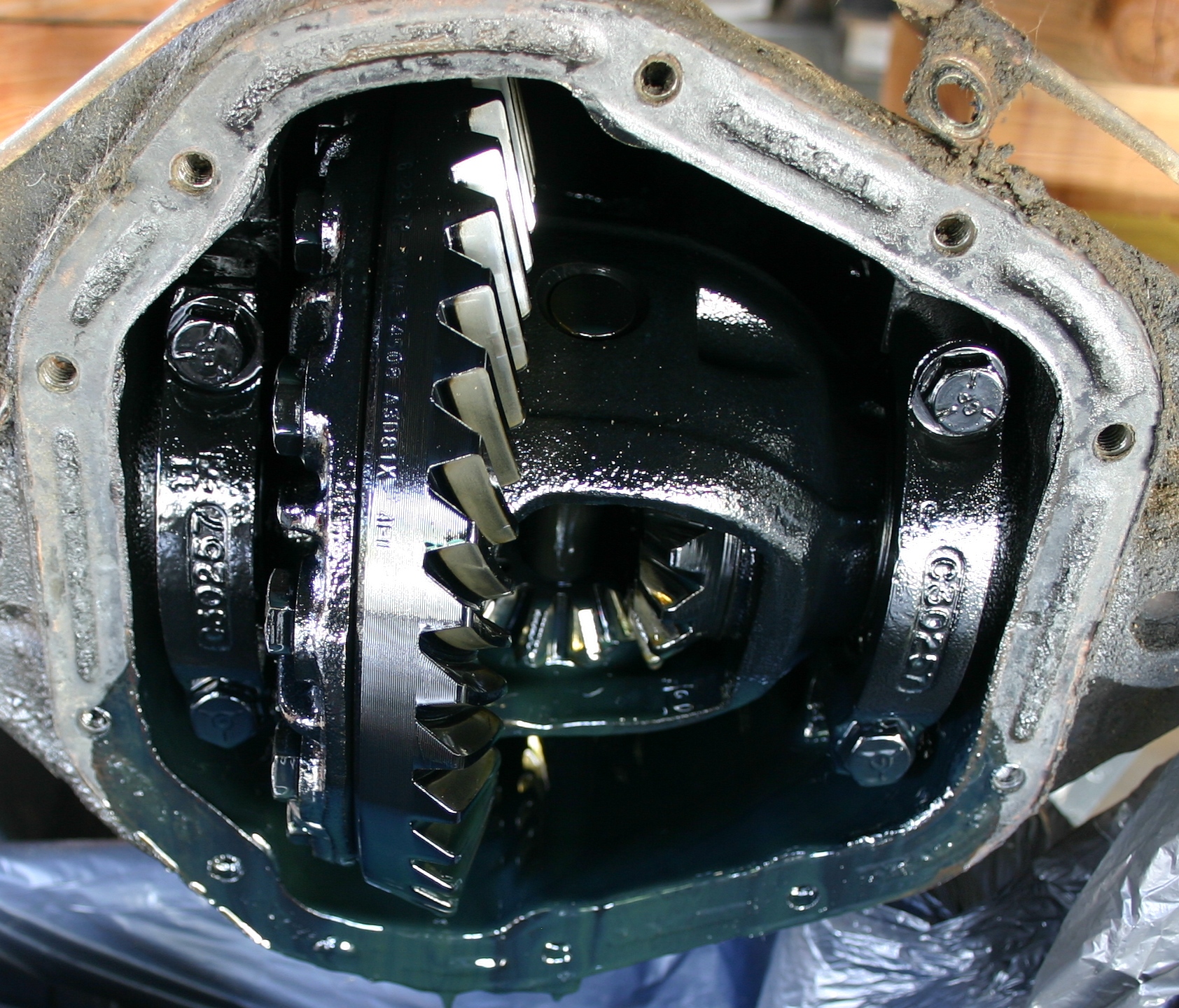

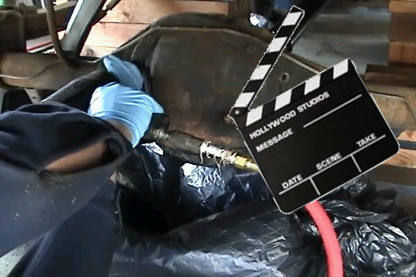

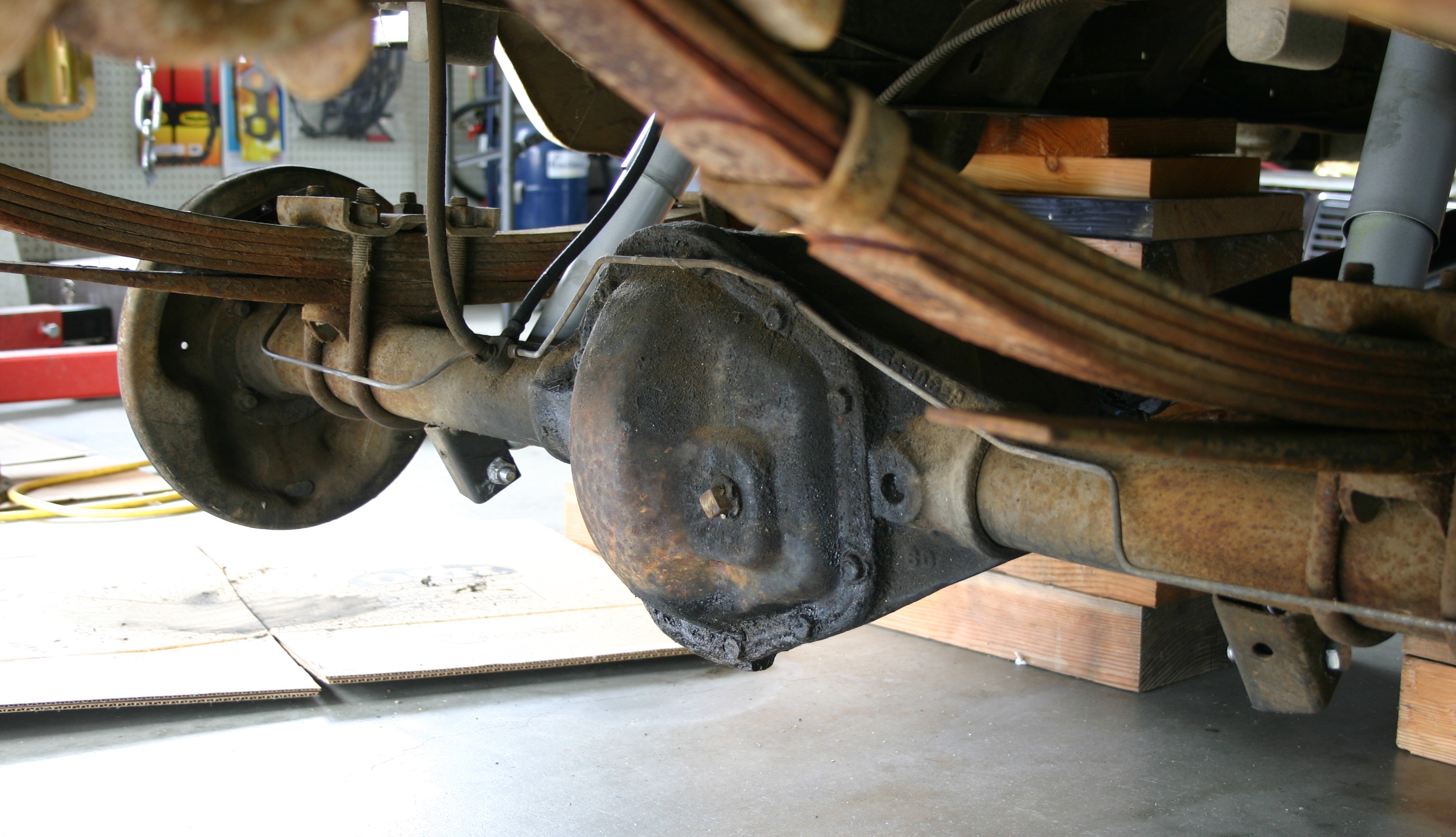

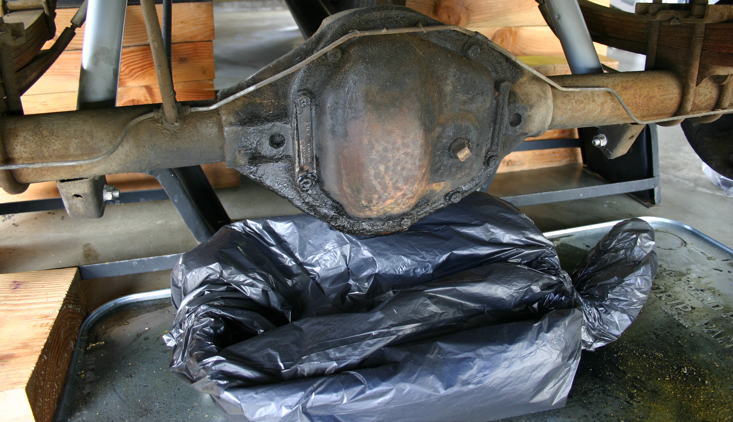

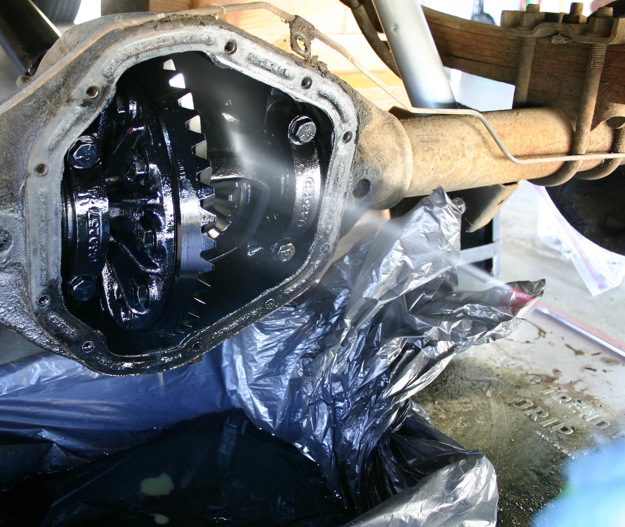

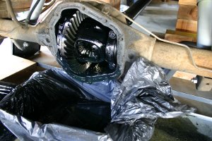

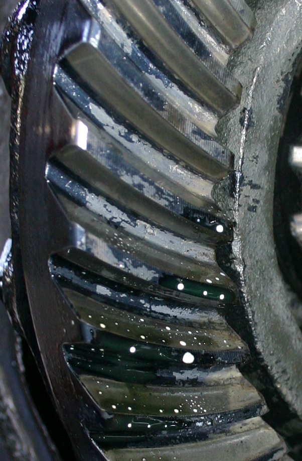

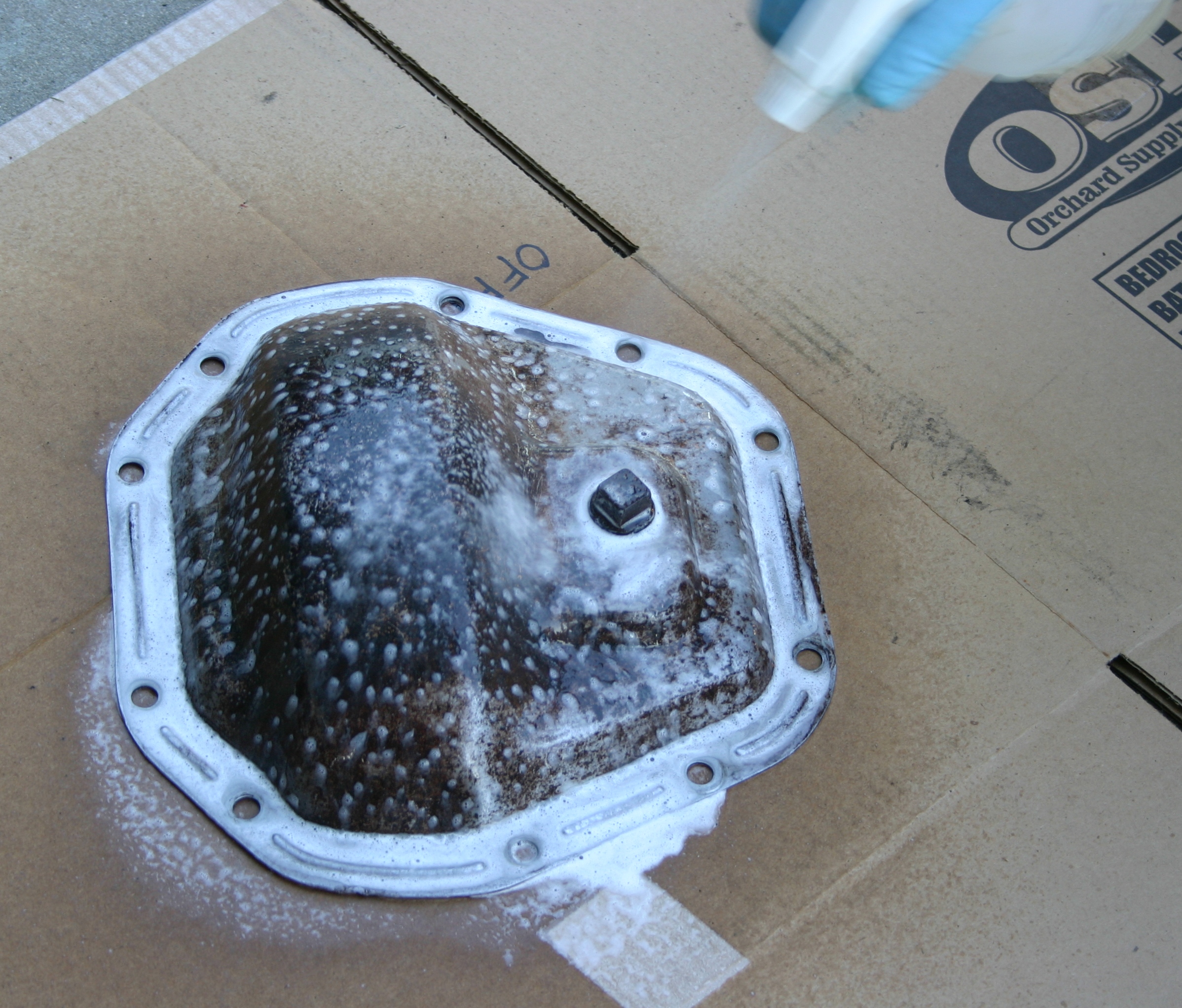

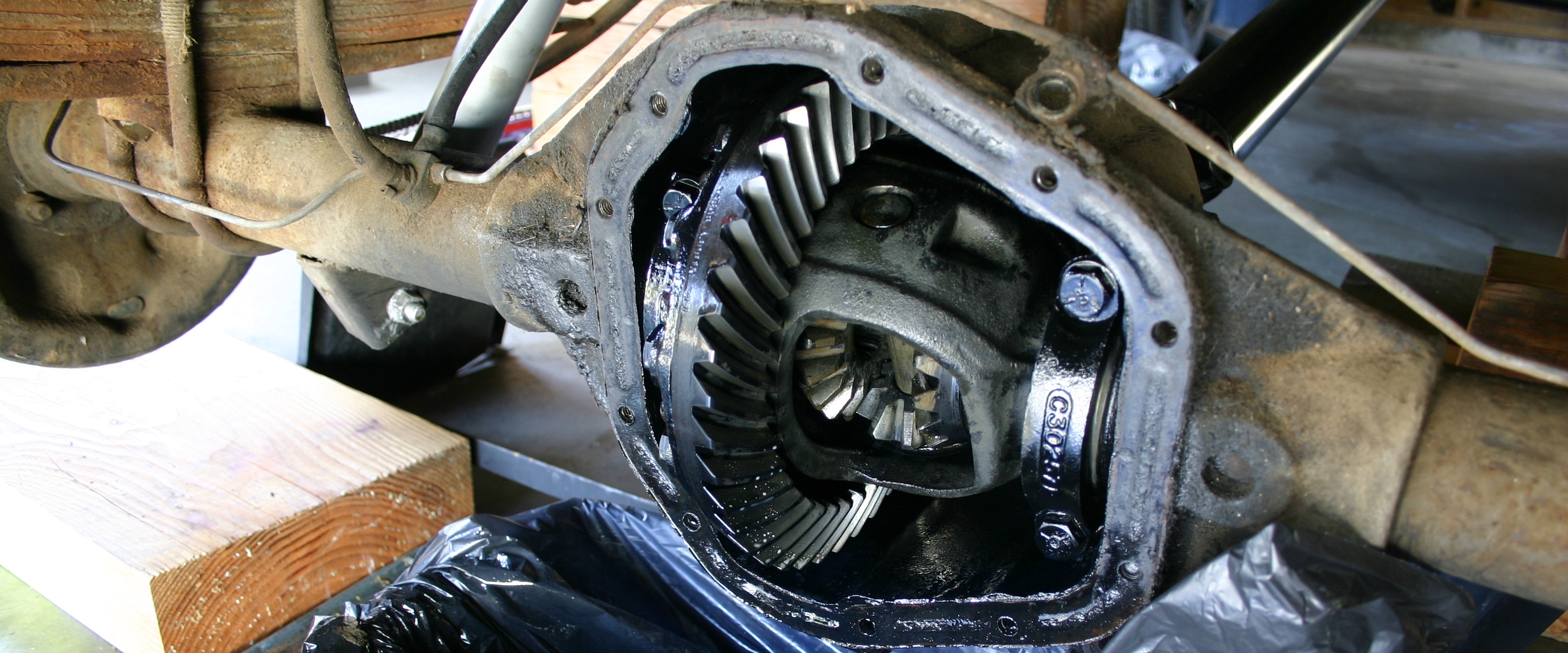

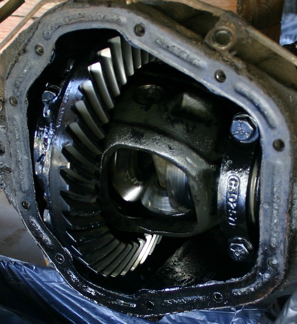

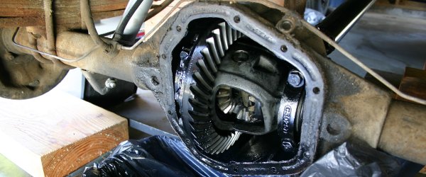

Earlier I remember reading from Frank that I might consider replacing the differential oil now, since that's what lubricates the wheel bearings. I certainly like this idea!
I've read that the old oil may be removed either by siphoning it out, or by loosening the differential cover. I like the idea of loosening the cover better, since I've never been good at siphoning thick liquids, and I'd like a chance to inspect the differential's condition! I don't want to work on the differential now, yet to satisfy my curiosity, I'd like to know how toasted it is.
This Morning's Question:
Robroy
- Is there any reason to remove the differential oil before putting the brakes back together? Perhaps because a thorough job includes the messy task of flushing the differential oil out of the axle tubes, and thus risking brake shoe contamination?
Robroy

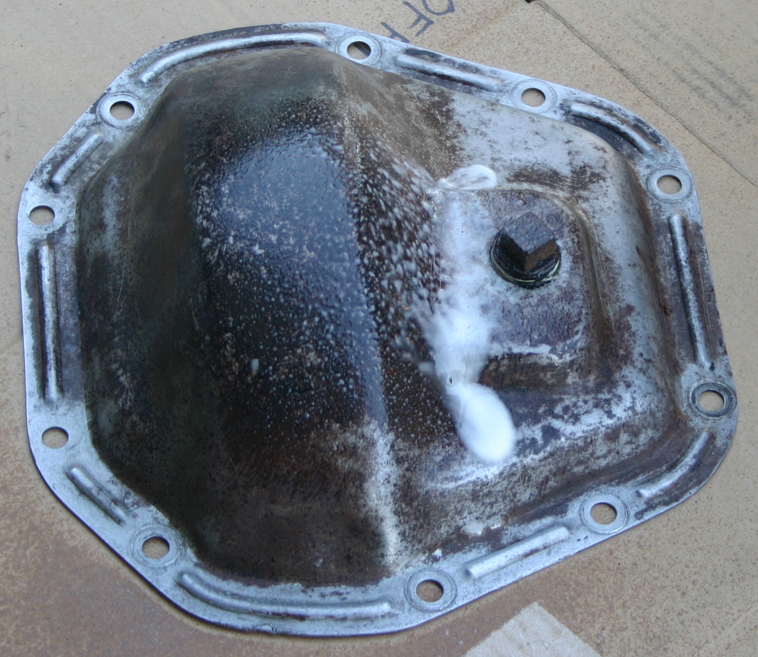

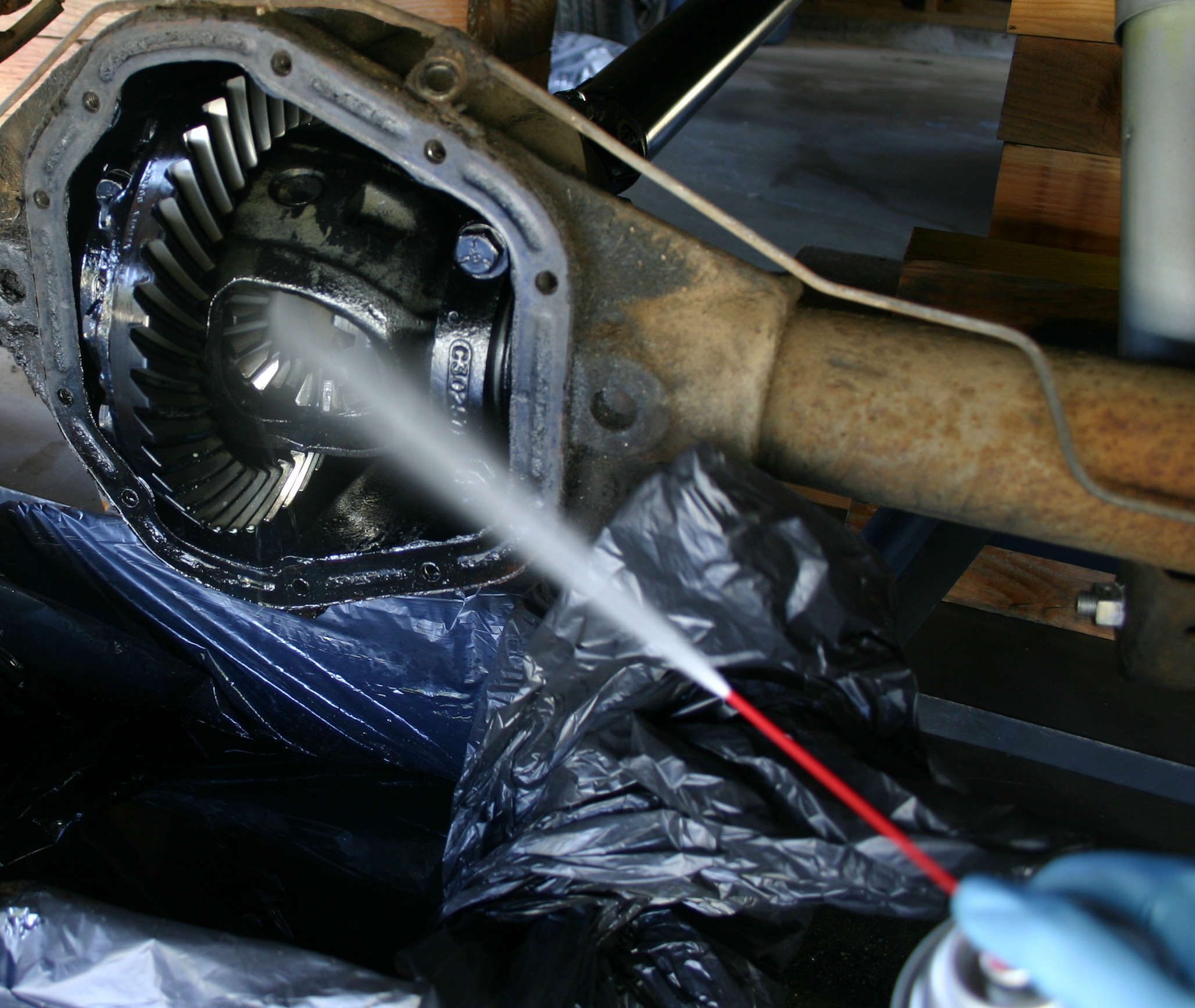

Robroy, it doesn't really matter whether you drain it before or after the brake replacement.
The tubes extend far enough that you shouldn't have any issues with contaminating the shoes/linings.
Whenever I flush a differential, I always use CRC Brakleen (the original formula in the red can). It may take 3-4 cans to clean it thoroughly, but the stuff cleans well and dries pretty quickly.
As a side note, whenever I replace bearings on a floating axle (like the D-60), I always pack the bearings well, just like front wheel bearings (you're already aware of that), then once the differential is full, I jack up each side of the truck independently so that the differential lube gets to the bearings sooner.

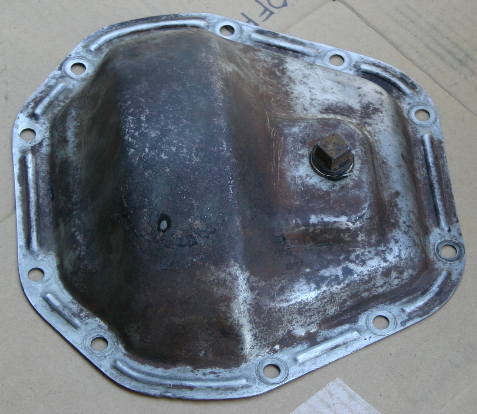

Good afternoon 70_F100, thanks for your superb reply!
Knowing that the order isn't super important, I think I'll wait until the truck's sitting on its wheels again before climbing under there to pull the differential cover off. It seems like it will be less likely to cause me to do some unexpected bench-presses that way (less likely to fall)!
Thanks again for your excellent reply 70_F100!
Robroy
Okay, perfect!70_F100 wrote:Robroy, it doesn't really matter whether you drain it before or after the brake replacement.
Excellent. Thanks for letting me know!70_F100 wrote:The tubes extend far enough that you shouldn't have any issues with contaminating the shoes/linings.
Okay! I don't happen to have the red-can CRC product at the moment, but I do have some off-brand brake cleaner that I'll try.70_F100 wrote:Whenever I flush a differential, I always use CRC Brakleen (the original formula in the red can). It may take 3-4 cans to clean it thoroughly, but the stuff cleans well and dries pretty quickly.
I can see the sense in doing that--thanks for pointing it out!70_F100 wrote:As a side note, whenever I replace bearings on a floating axle (like the D-60), I always pack the bearings well, just like front wheel bearings (you're already aware of that), then once the differential is full, I jack up each side of the truck independently so that the differential lube gets to the bearings sooner.
Robroy

The off-brand stuff works pretty well, too.robroy wrote:Okay! I don't happen to have the red-can CRC product at the moment, but I do have some off-brand brake cleaner that I'll try.70_F100 wrote:Whenever I flush a differential, I always use CRC Brakleen (the original formula in the red can). It may take 3-4 cans to clean it thoroughly, but the stuff cleans well and dries pretty quickly.
Robroy
The main thing I've found is that the non-chlorinated (green can) CRC product doesn't clean nearly as well as the red can.
The stuff that Advance sells that comes in the black-and-gold can works quite well, and is my second preference to the CRC red-can product.

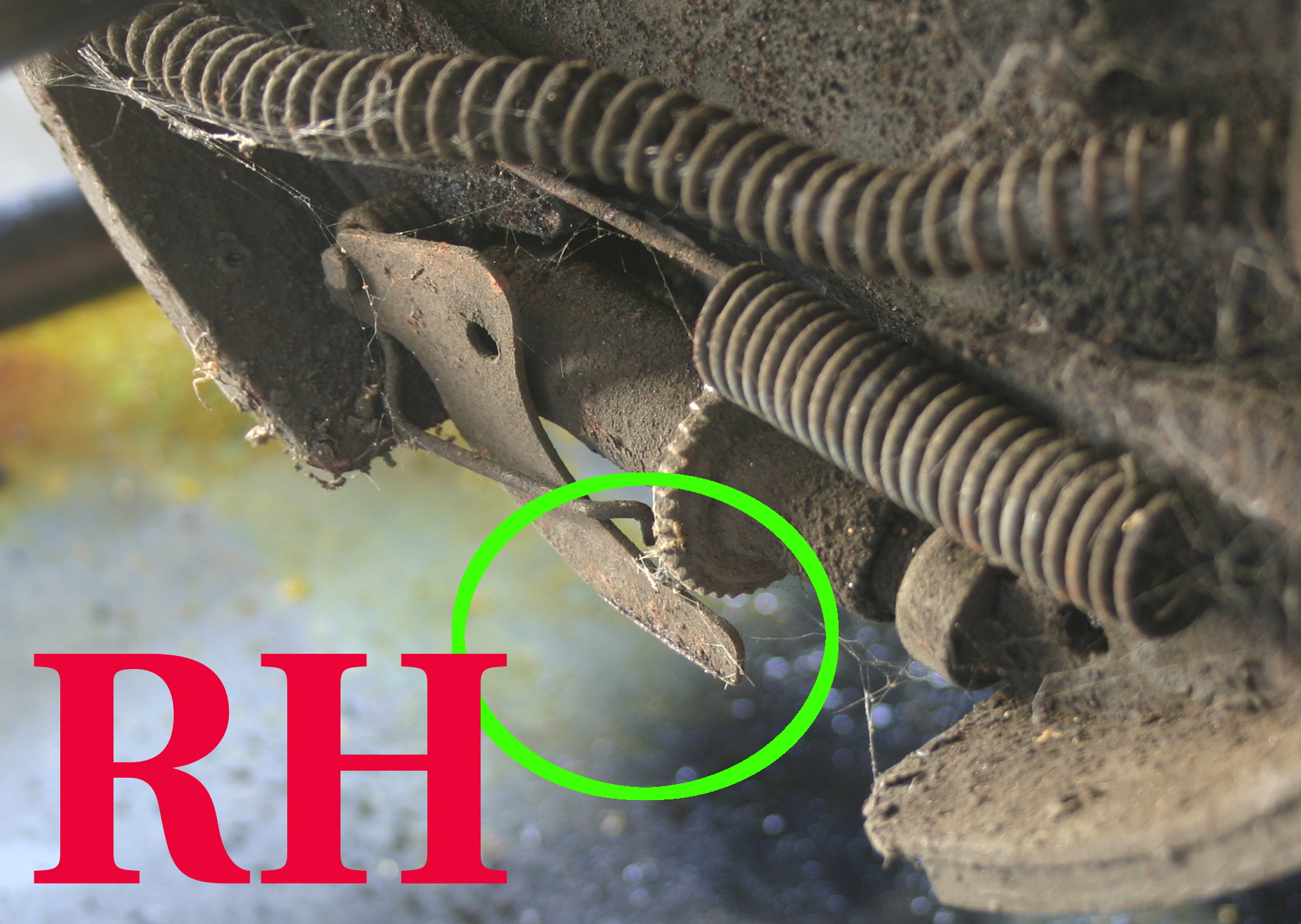

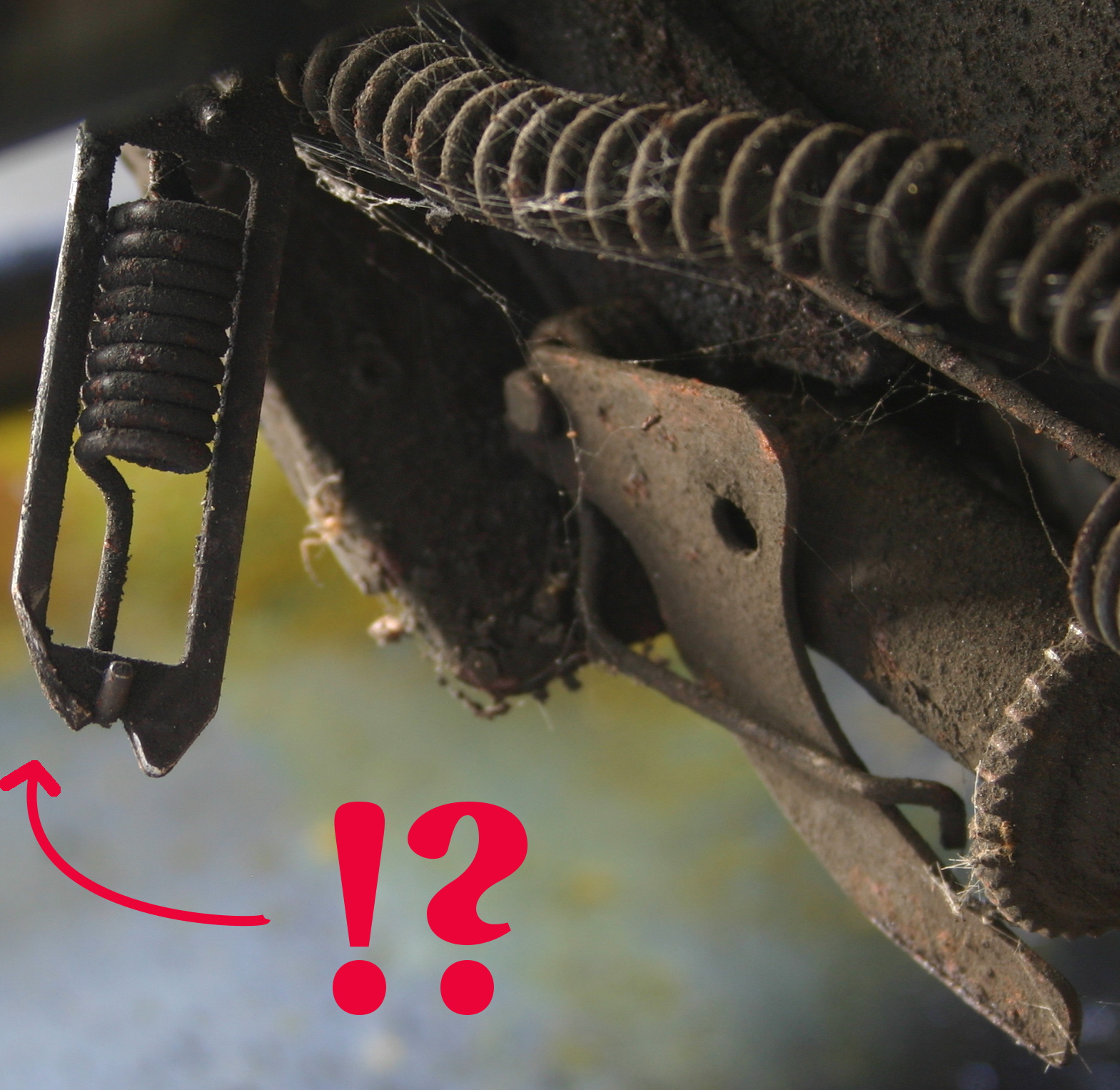

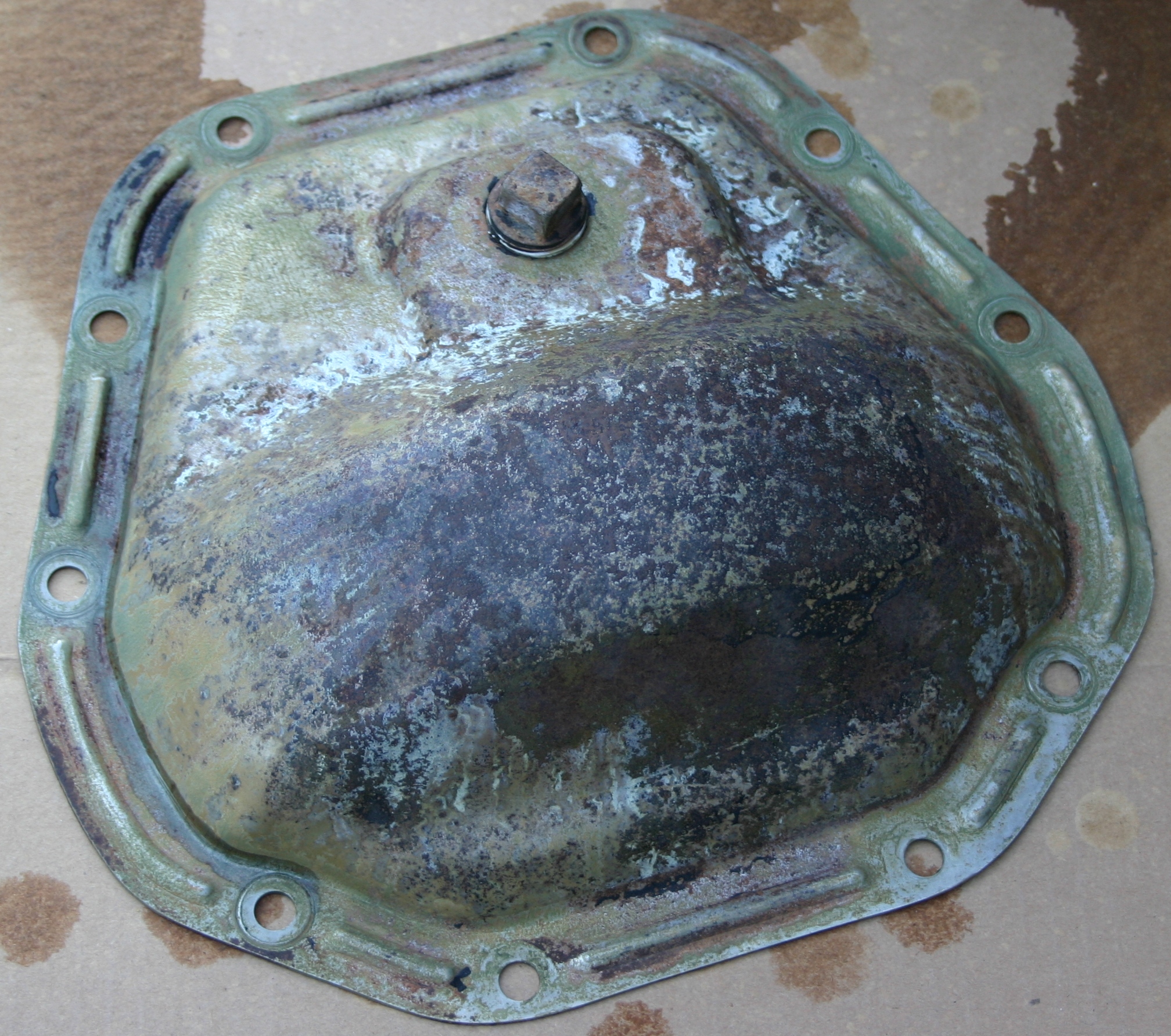

Today's Update:
Yesterday (Monday), I rolled down to NAPA to do a visual comparison between their new auto-adjuster kit, UP 80849, and my existing hardware. Unfortunately the adjuster hardware kits for both sides (RH=UP 80849; LH=UP 80848) were made in China, so I wasn't able to buy either.
Yet the visual comparison indicated that my current LH hardware is in decent shape; it would probably be a waste to replace it.
The right-hand auto-adjuster hardware, on the other hand, is clearly problematic! You can see how both the lower portion of the lever, and the part on the end of the cable, have been ground away--this is undoubtedly what caused the deep groove in that drum!
So there's no doubt that I'll need the full kit for the left-hand side!

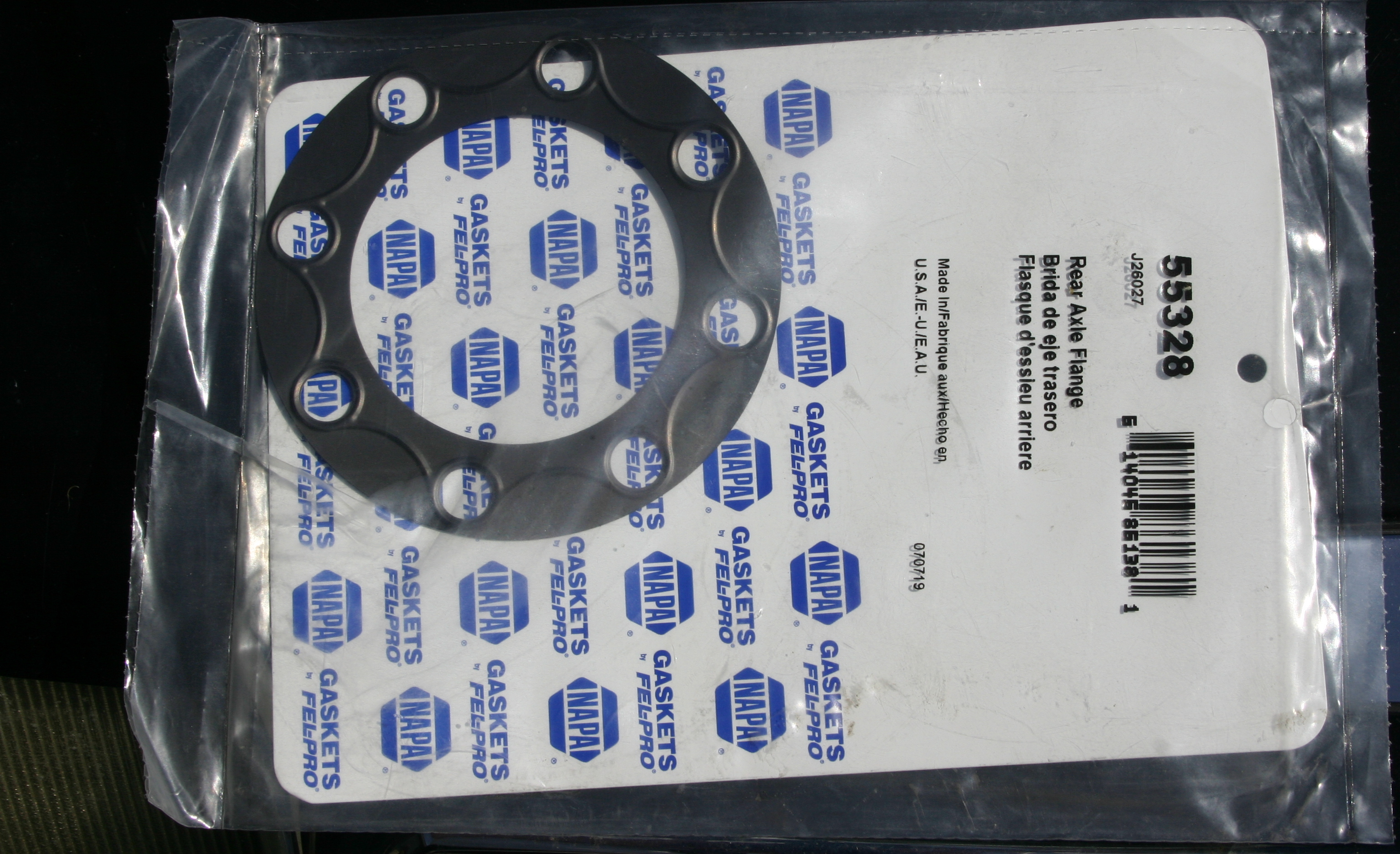

While there, I picked up a pair of USA-made axle flange seals (FPG 55328) for $3.05 each.

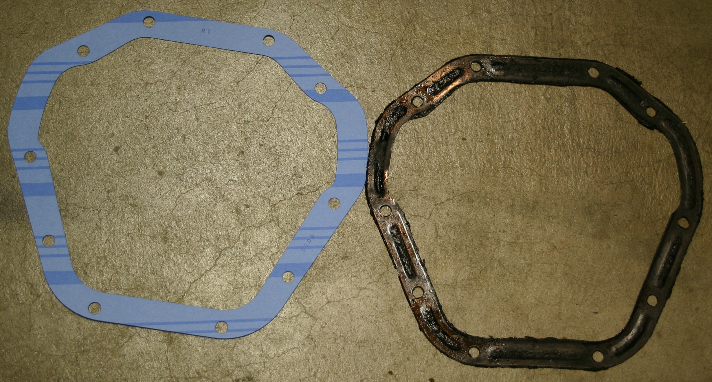

And in preparation to flush the differential out, I picked up a USA-made Dana 60 cover gasket (RDS 6095-1 for $6.42).
I still need to find a decent auto-adjuster kit for the right-hand side! I'll try Elmer's next, since they seem to have access to Wagner brake parts--so far those have had more favorable origins.

Today's Update:

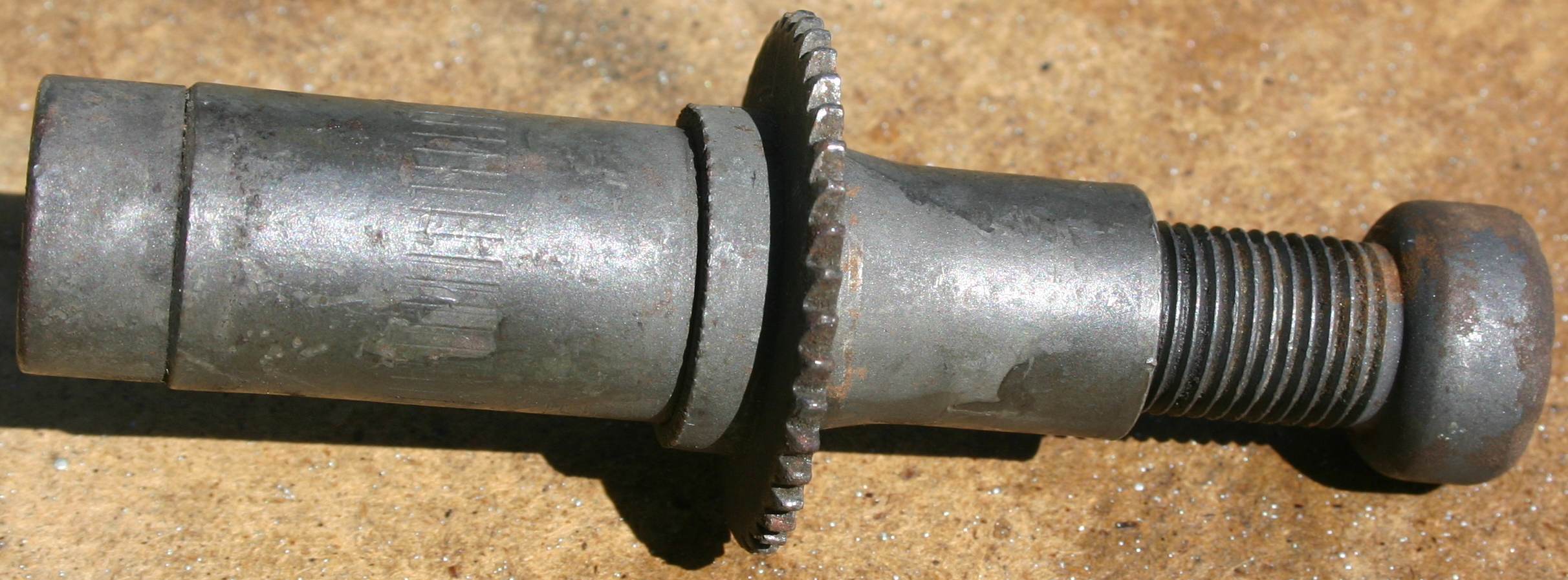

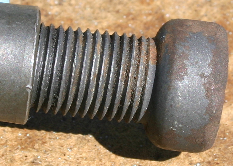

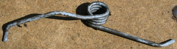

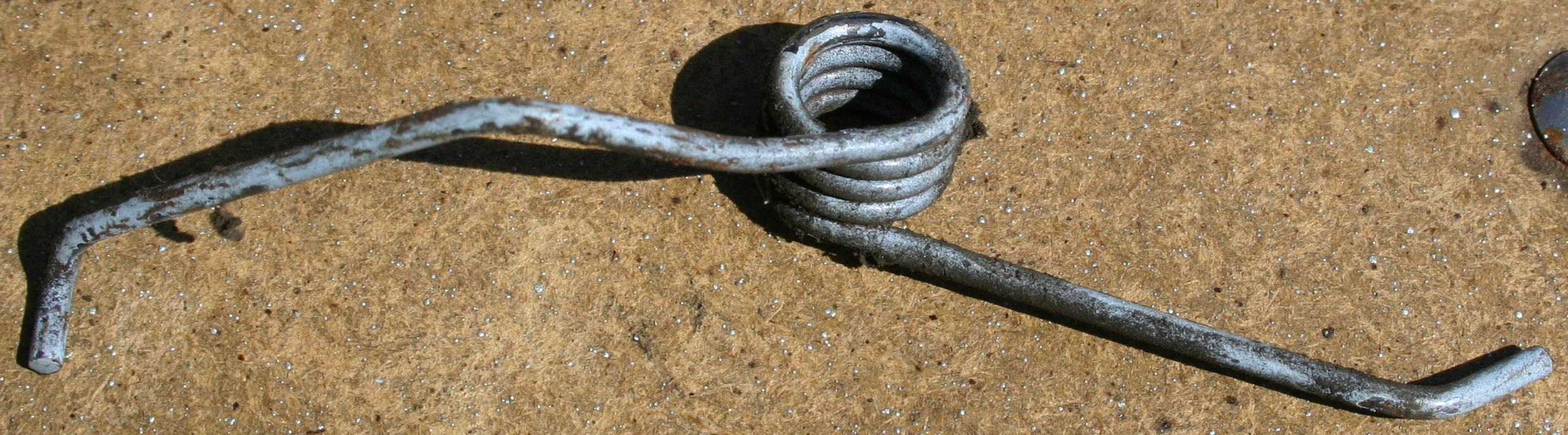

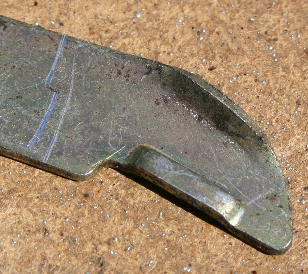

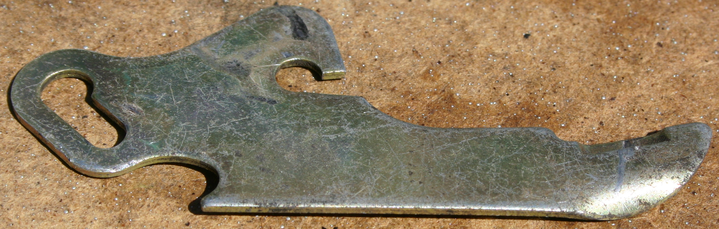

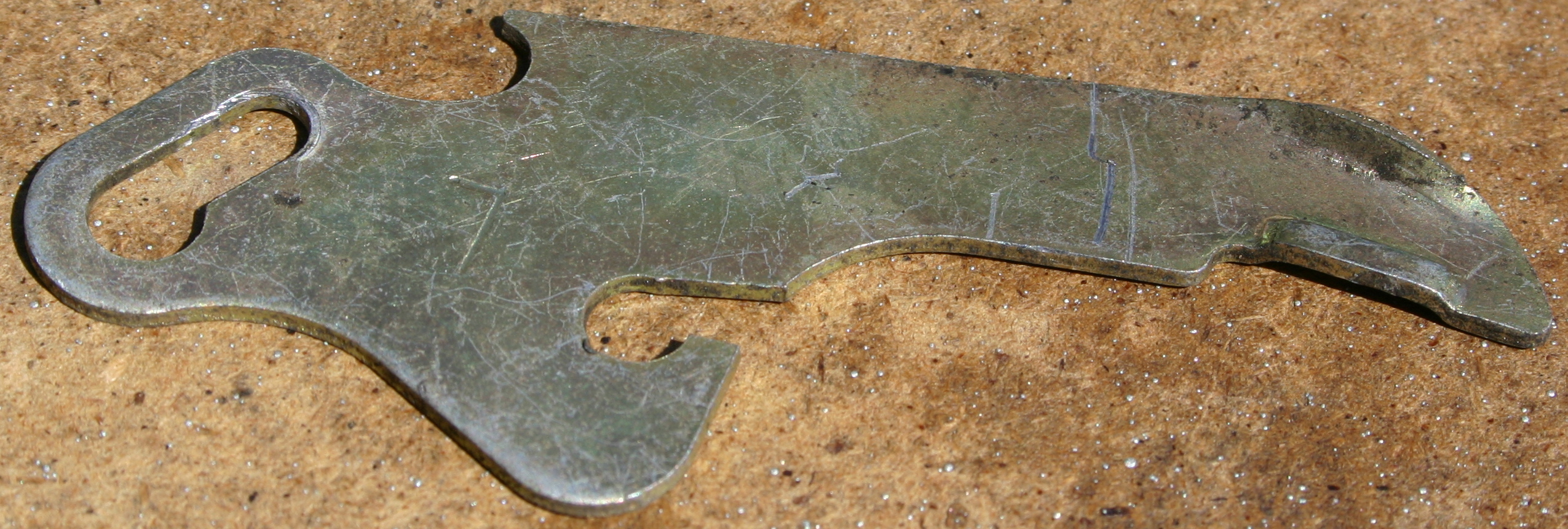

Good afternoon!

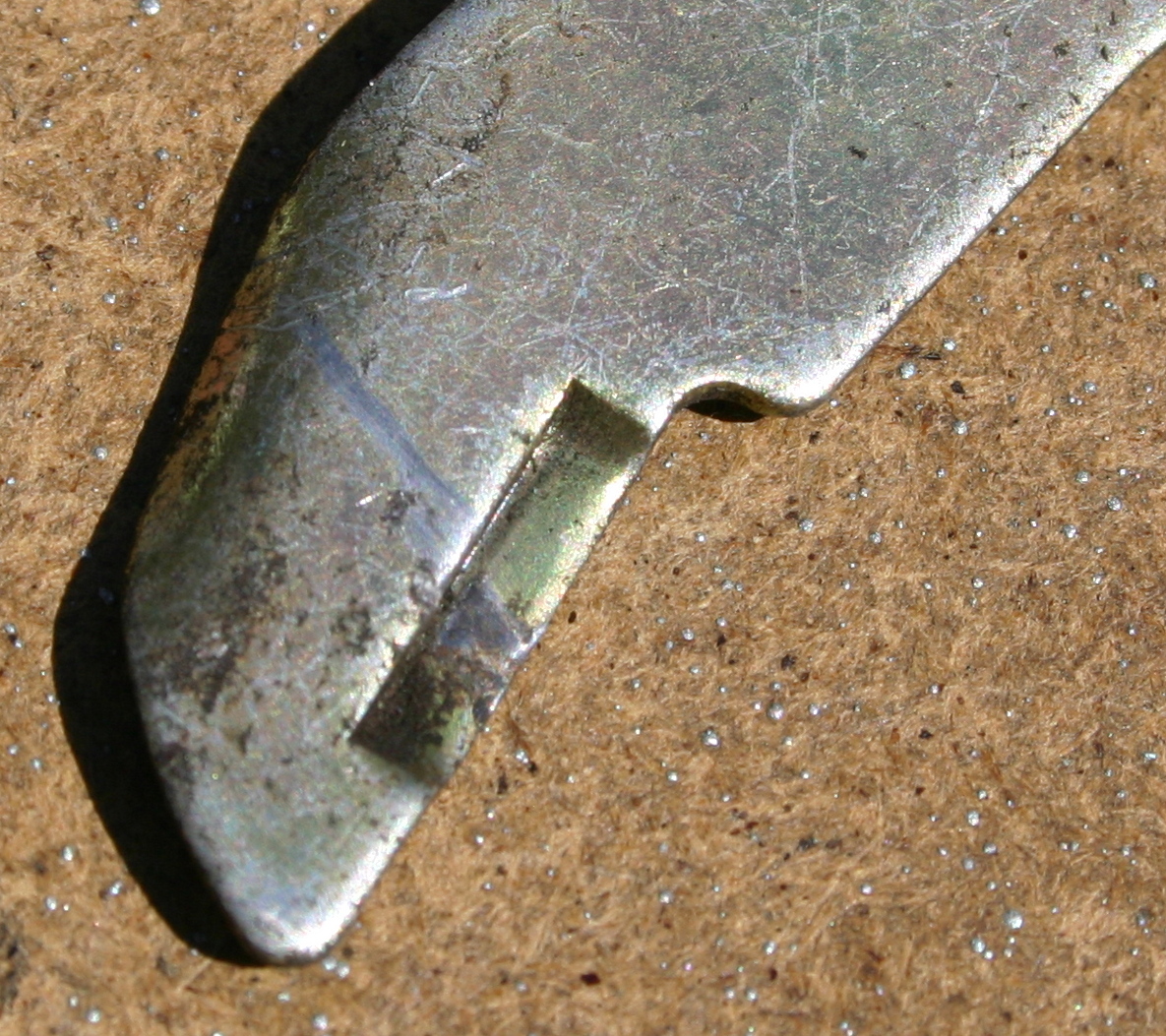

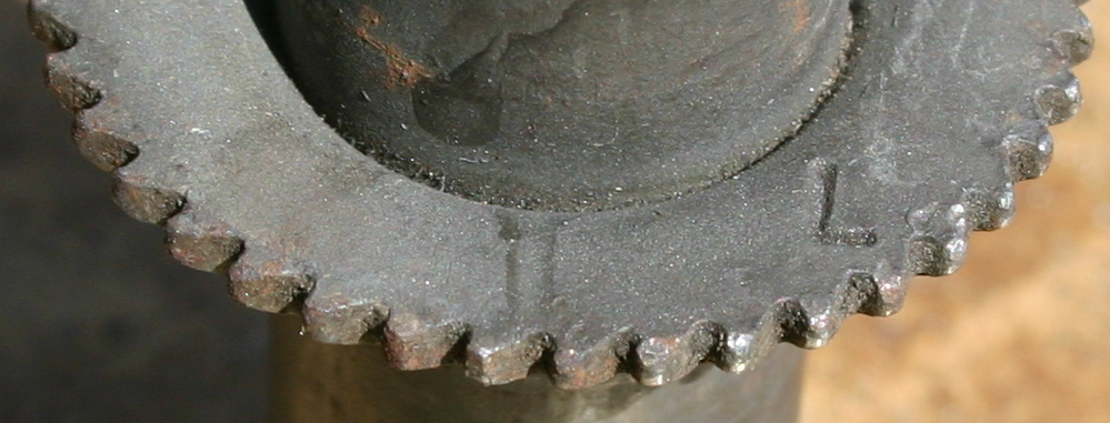

I called around earlier this week and found a source for some Carlson automatic adjusting kits, which are USA-made, but I'll have to special-order them. I spoke to Brake Supply Plus. I think it's worth the extra trouble and expense to have these USA-made parts, so I'll go this route.
Yet given the relative difficulty I've have finding USA-made kits, I'm uncertain about whether I should be ordering the kits for both sides and replacing all of the adjusting hardware at once, or whether the LH hardware's fine (I already know that the RH hardware's toasted).
Perhaps y'all can take a close look at these photos and supply your experienced opinions! All of these may be clicked upon for super large, detailed editions.
The screw looks fair to me; its teeth don't look new, but I'm not sure if they're worn enough to consider replacing them or not.
Here's the lever. It seems to have a slight bend in it that I'm not sure is by-design, but its overall condition seems good to me.
And here's the spring that sits under the lever. Other than being dusty, it looks pretty good to me. That said, I recognize that it's not possible to see a weakened spring!
Would y'all recommend the RH kit only, or based on the above photos, would it be prudent to replace the LH kit as well? I believe the kits are around $65 each, including the charge to special-order them.
Thanks so much for the outstanding guidance!
Robroy
Robroy

i see nothing wron with the last photos in the last post. so you dont really need to replace that hardware. however over the years springs can become weaker as they are used. so getting a new sprign kit wouldnt hurt anything. i dont think you ned the adjustign hardware as the stuff you have looks fine. spring would be the only thing i would replace if you want to do it once and forget it.
- robroy

Good evening Fordman, thanks very much for checking out my photos and replying!
Thanks again for your excellent reply Fordman!
Robroy
Perfect, thanks!fordman wrote:i see nothing wron with the last photos in the last post. so you dont really need to replace that hardware.
Okay, understood! I know that this particular spring's sold separately; I'll ask about this when I go to specialty brake place on Monday.fordman wrote: however over the years springs can become weaker as they are used. so getting a new sprign kit wouldnt hurt anything. i dont think you ned the adjustign hardware as the stuff you have looks fine. spring would be the only thing i would replace if you want to do it once and forget it.
Robroy

I pulled the Dana 60 cover off to drain the fluid earlier, and since this was the first time I'd ever seen inside of a differential, I video-recorded it for y'all to watch along with me!
I grabbed a cat liter box and put it in a garbage sack to catch the gear oil; it seemed to work surprisingly well, although I haven't dealt with the clean-up yet.
And here's the video of the cover removal! As you know, the high quality H.264 format works only with up-to-date computers, while the WMV format will play anywhere.
H.264 (21MB) WMV (19MB)
I'm guessing that a visual inspection's best done once the gears have been flushed with brake cleaner, yet can your experienced eyes detect anything noteworthy?
I'm planning on letting it drain over night and doing the messy brake cleaner job tomorrow!
Thanks very much for all the superb guidance!
Robroy

- 70_F100
- Moderator
- Posts: 2999
- Joined: Mon Oct 22, 2007 11:23 am
- Location: North Carolina, Kernersville
Re: 1972 F250 12"x2.5" Bendix rear drum brake rebuild: advice?
Robroy, it looks pretty good inside. I can't immediately see any visible wear, and it doesn't appear that there is any metal in the lube.
However, there are a few things to look for that really can't be determined from photos:
1) Check the leading and trailing edges of the ring gear teeth for wear. The best way to do that is to feel the outer edges of the teeth (the longest edges). These should not feel sharp.
2) Check the spider gear differential shaft for wear. This would show up as movement of the shaft within the bore of the carrier and/or looseness of the pinion gears (spider gears) on the shaft.
3) Check the side gears and pinion gears for excessive clearance. There should be some movement and free play of the gears, but they should essentially run straight, with no "rocking" motion on the shaft or in the bores for the axle (side) gears.
4) Check the ring and pinion for excessive backlash. To do this, hold the pinion stationary, and move the ring gear back and forth. There should only be a few thousandths backlash between the ring and pinion. If you can't find a good way to hold the pinion tightly, take a bolt with a large washer and put it in the hole (top or bottom) on the right side of the ring gear, so that the washer contacts the ring gear in such a way as to "lock" the ring gear, and turn the pinion back and forth. Again, a few thousandths is what you're looking for.
Looking good, my friend!!!
Good evening 70_F100, thanks for your super generous reply!
This was surprising to me because while installing the differential's input yoke, I noticed that I could turn the yoke quite a bit in both directions before it seemed to "catch." Perhaps I could turn it as much as five degrees, if my memory's working properly.
Tomorrow I'll turn the drive shaft by hand while keeping an eye on the ring gear to see if it still looks like a minimal amount (a few thousandths) of play!

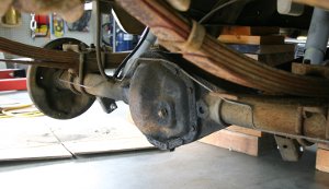

I invested some good hours this afternoon and made some progress!
Here I'm spraying copious amounts of brake cleaner in the general direction of the differential.
Before beginning this, I prepared with the blue gloves I always wear, long sleeves, goggles, and a quality charcoal respirator. I knew I'd be using a significant amount of cleaner in there, and the small area under the truck tends to concentrate vapors--I didn't have much of an appetite for inhaling any more brake cleaner than was absolutely necessary!
I've been getting these decent under-truck photos by having the camera on a tri-pod (at its very shortest height setting) and using an infra-red shutter remote control. There's no way I'd normally have the coordination to take photos and spray brake cleaner at the same time, and I'm not nearly cruel enough to ask Kasie to climb under there for the sake of photo-documentation!
To aide the cleaner's coverage, I slipped an axle in the housing and used it to spin the differential gears around, while spraying.
Here's how it began to look without the uniform coat of gear oil.

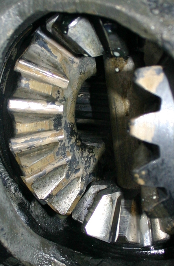

And here are a couple of ultra close-ups: the LH ring/pinion (on the left) and the ring (on the right).
Of course I HAD to spin the gears with the camera set up for a long exposure! This gave me a sense of appreciation for how tough this rear end really is. Even spinning it by hand looked so dramatic; just imagine what it's like in there while driving around a corner at 55 MPH!

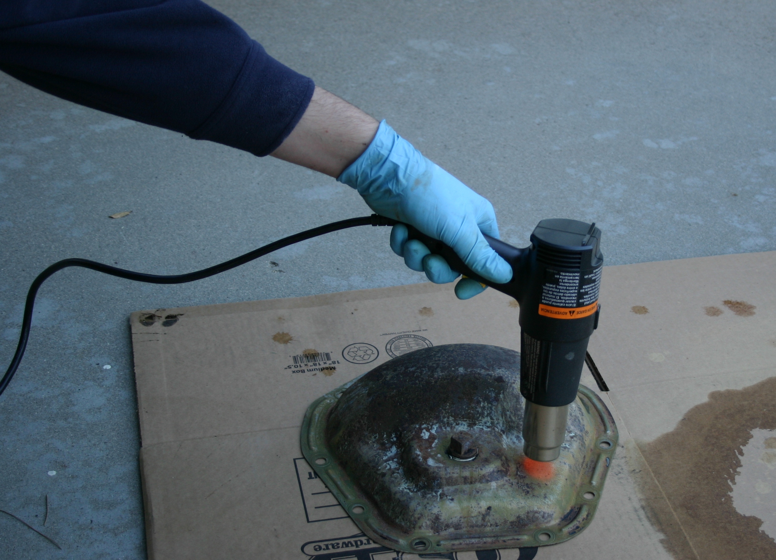

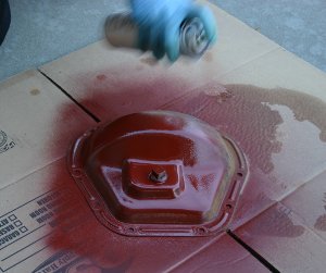

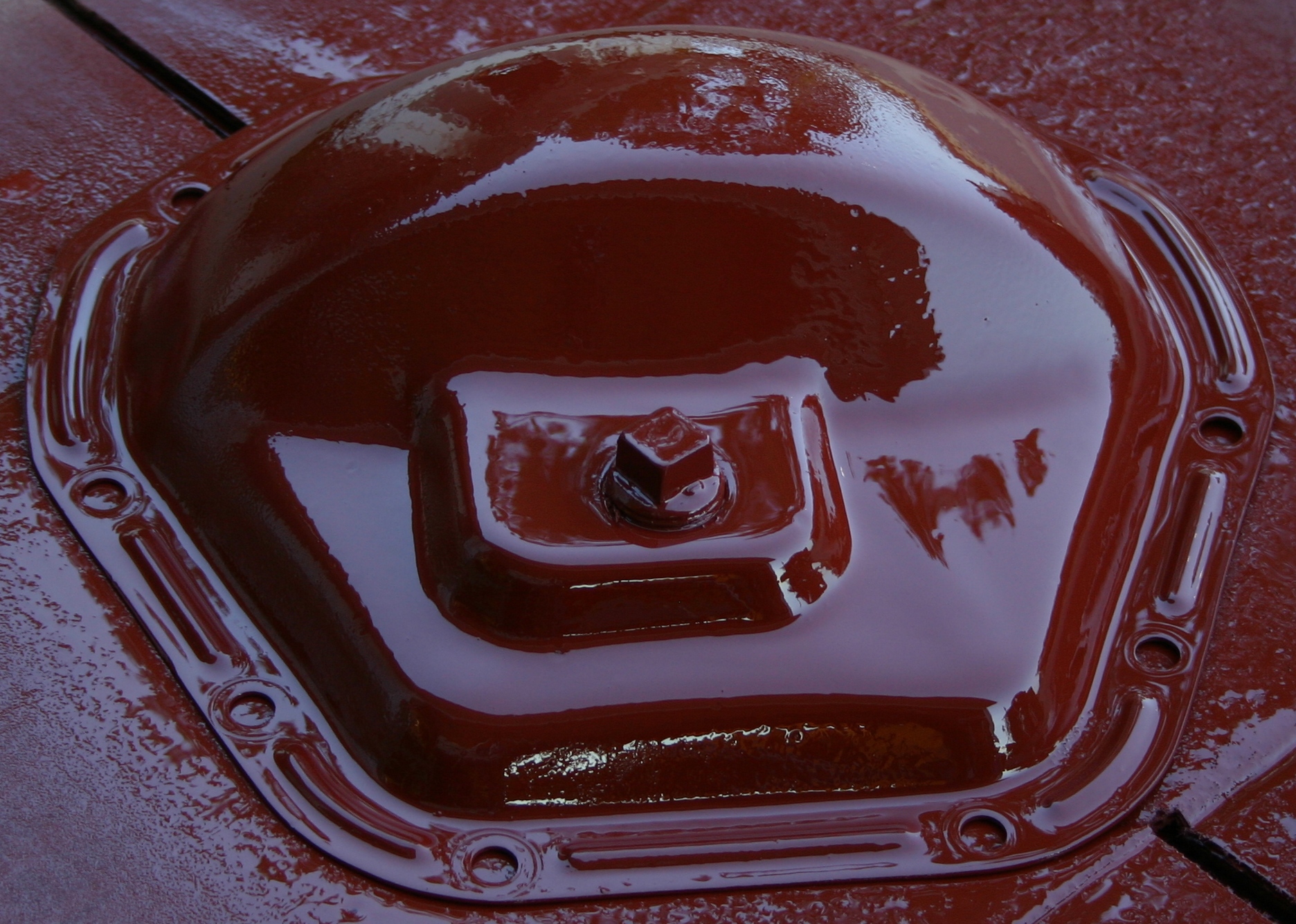

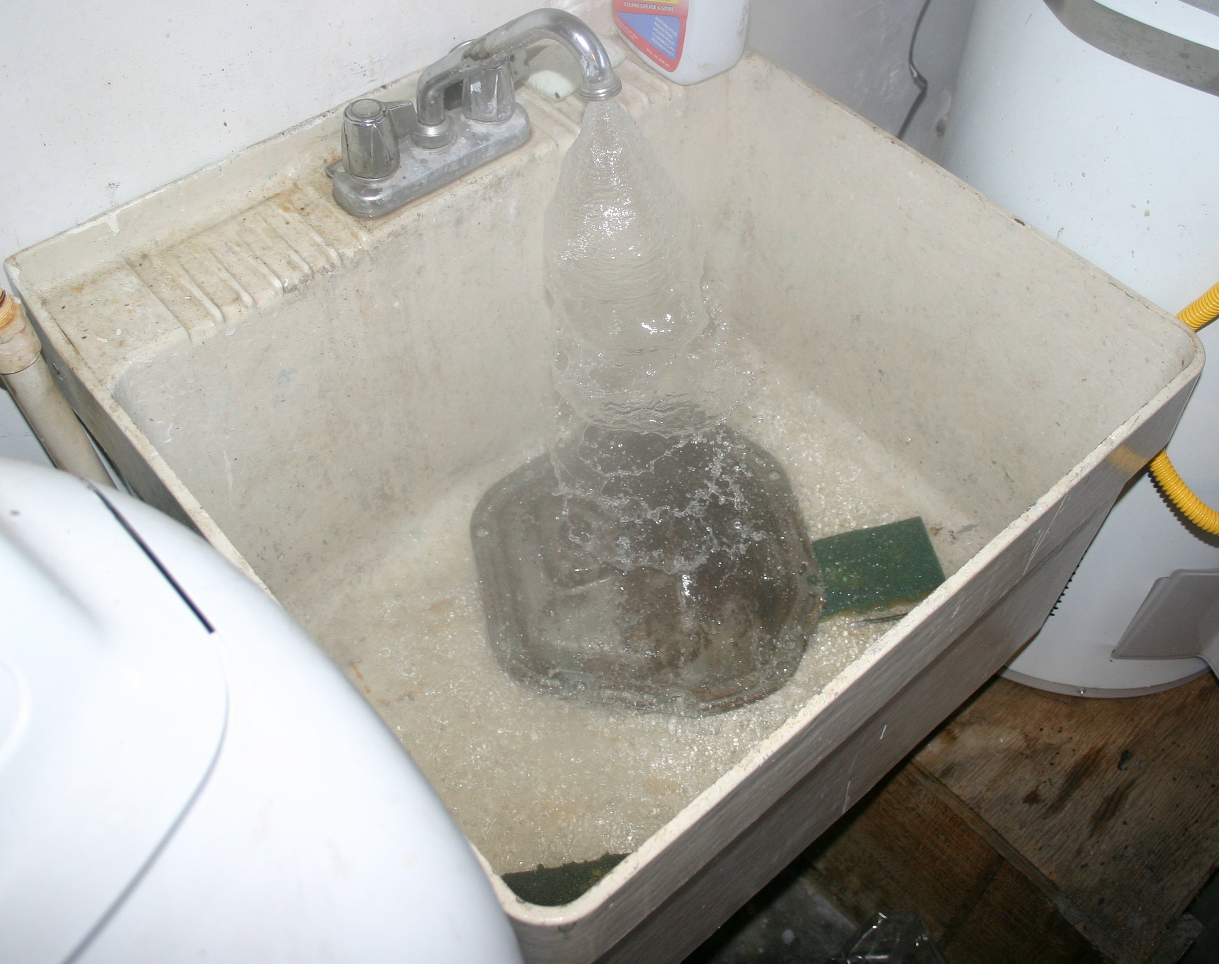

Next I turned my attention to the cover. It was N-A-S-T-Y! I spent an hour or more cleaning it up using every method at my disposal, although the most effective turned out to be dousing it with de-greaser and using a fresh Scotch-Brite pad with LOTS of "elbow grease," rinsing it with torrents of hot water, and repeating!
I got it just about as clean as it was going to get (by hand at least)! Then I thought, "What the heck," and hit it with some Rust Bullet Metal Blast, which as you know, is a phosphoric acid solution.
I let it sit that way for about five minutes (the directions said between two and twenty minutes was a good range), then doused it with hot water! The directions specifically call for hot water--perhaps it helps to wash off the acid more effectively. I'm truly fortunate to have this sink in the garage that's hooked directly up to the water heater; it produces scalding-hot water and lots of it!
Naturally, I wanted to get it bone-dry before paint, and I wasn't patient enough to let it air-dry on its own! First I tried the fan (left), then I broke out the heavy artillery (right). Note that the orange light's reflecting off of the cover from the coils in the hot air gun; I didn't get the cover red-hot!

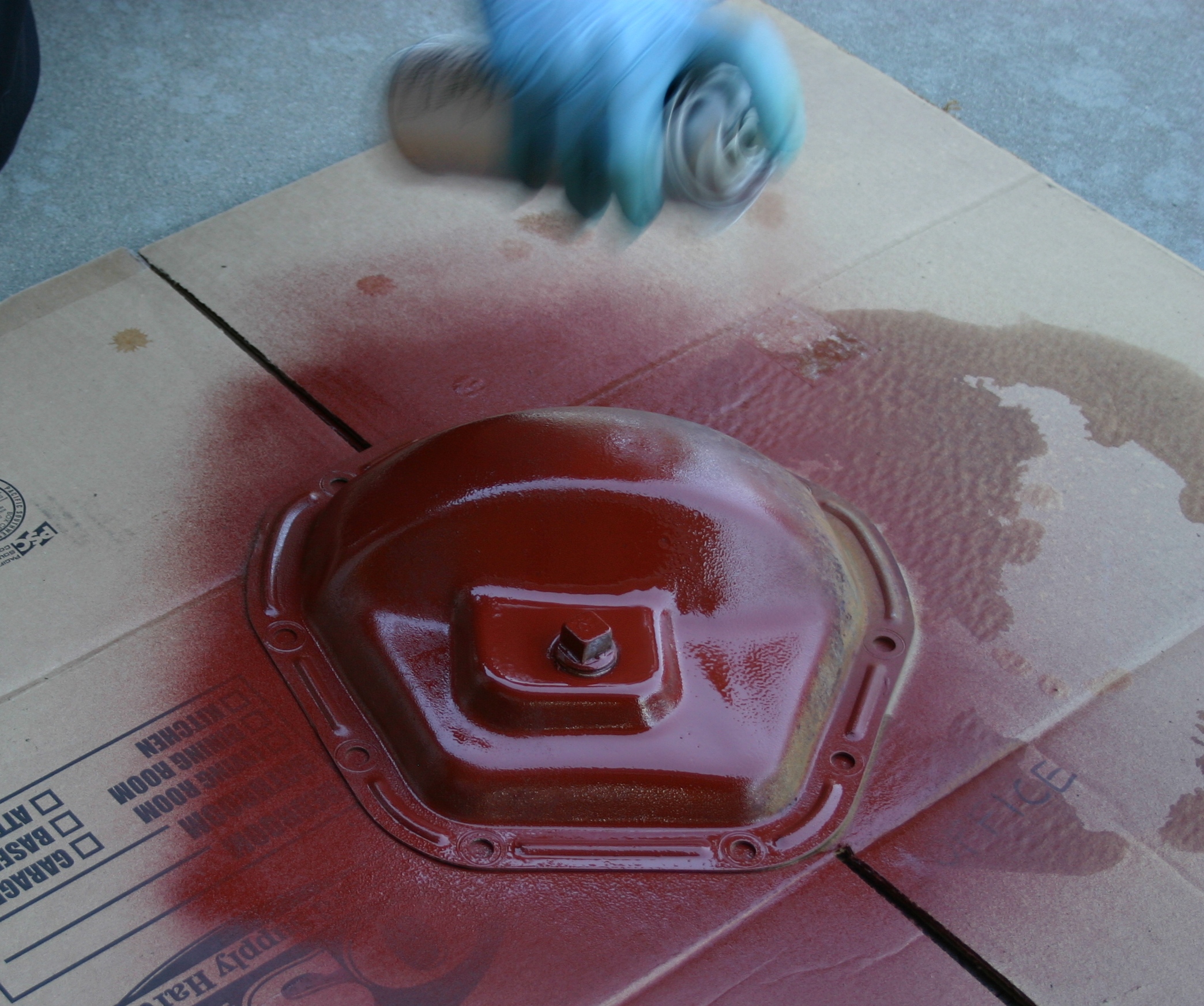

And here's it's cleaned, phosphoric acid treated, washed off, and bone dry. Ready for primer!
Since my hand-cleaning job left plenty of surface rust on the cover, I decided to use Eastwood's Rust Encapsulator as a primer (it's a primer by nature). It comes in both red and black. I like the red when I'll be top-coating with black, since it makes coverage visibly discernible. I haven't decided on black here though; I might top-coat with a white, then a yellow.
The Rust Encapsulator looks glossy here, yet it will dry matte.

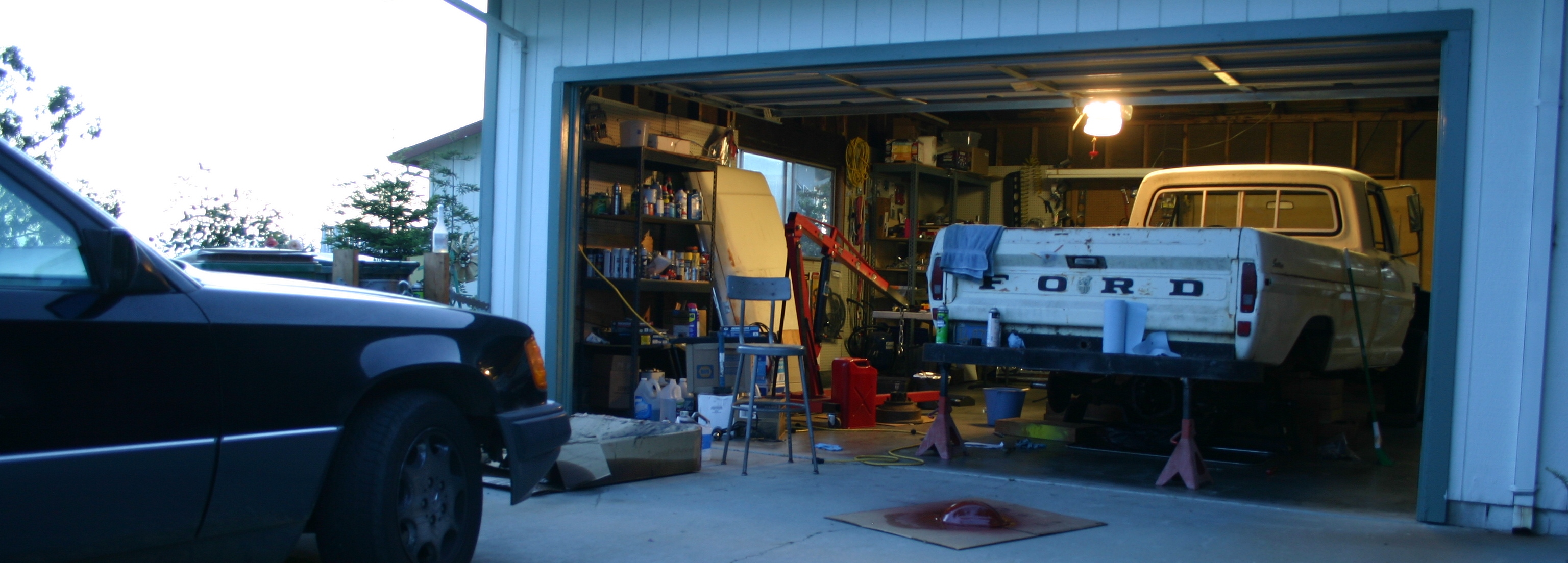

Here's a wide-angle of my fun zone, for general amusement.
And here's a side-by-side comparison between the new RDS 6095-1 and the original Dana 60 gasket. It looks like a good match to me!

Excellent! I didn't see any metal in the lube or the housing either.70_F100 wrote:Robroy, it looks pretty good inside. I can't immediately see any visible wear, and it doesn't appear that there is any metal in the lube.
I spent some time feeling all over the ring gear teeth, and didn't find anything that I'd call a sharp edge--perhaps I'm OK here!70_F100 wrote:However, there are a few things to look for that really can't be determined from photos:
The shaft did have some play in it both within the bore of the carrier and with the pinion/spider gears, yet the play was very slight. It was just barely enough to feel (and hear); it must have been only a few thousandths.70_F100 wrote:2) Check the spider gear differential shaft for wear. This would show up as movement of the shaft within the bore of the carrier and/or looseness of the pinion gears (spider gears) on the shaft.
This seemed OK! There seemed to be a small amount of movement, yet it felt surprisingly tight; everything seemed to be running straight with no rocking motion!70_F100 wrote:3) Check the side gears and pinion gears for excessive clearance. There should be some movement and free play of the gears, but they should essentially run straight, with no "rocking" motion on the shaft or in the bores for the axle (side) gears.
To my surprise, the results of this test were also rather good; there appeared to be merely a few thousandths of play there! Yet I'm not certain if my test was proper. With my eyes on the drive shaft, I turned the ring gear back and forth just until the drive shaft began to move. I tried this a few times, and I could turn the ring gear only a tiny amount either way before hearing a clunk and seeing the drive shaft rotate.70_F100 wrote:4) Check the ring and pinion for excessive backlash. To do this, hold the pinion stationary, and move the ring gear back and forth. There should only be a few thousandths backlash between the ring and pinion. If you can't find a good way to hold the pinion tightly, take a bolt with a large washer and put it in the hole (top or bottom) on the right side of the ring gear, so that the washer contacts the ring gear in such a way as to "lock" the ring gear, and turn the pinion back and forth. Again, a few thousandths is what you're looking for.
Thank you very much 70_F100!!! And thanks so much for those wonderful inspection steps--they were fun to carry out and very interesting, especially since this is the first differential I've opened up!70_F100 wrote:Looking good, my friend!!!

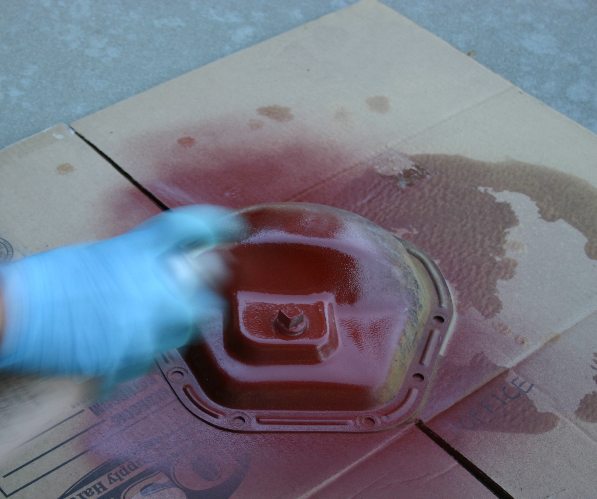

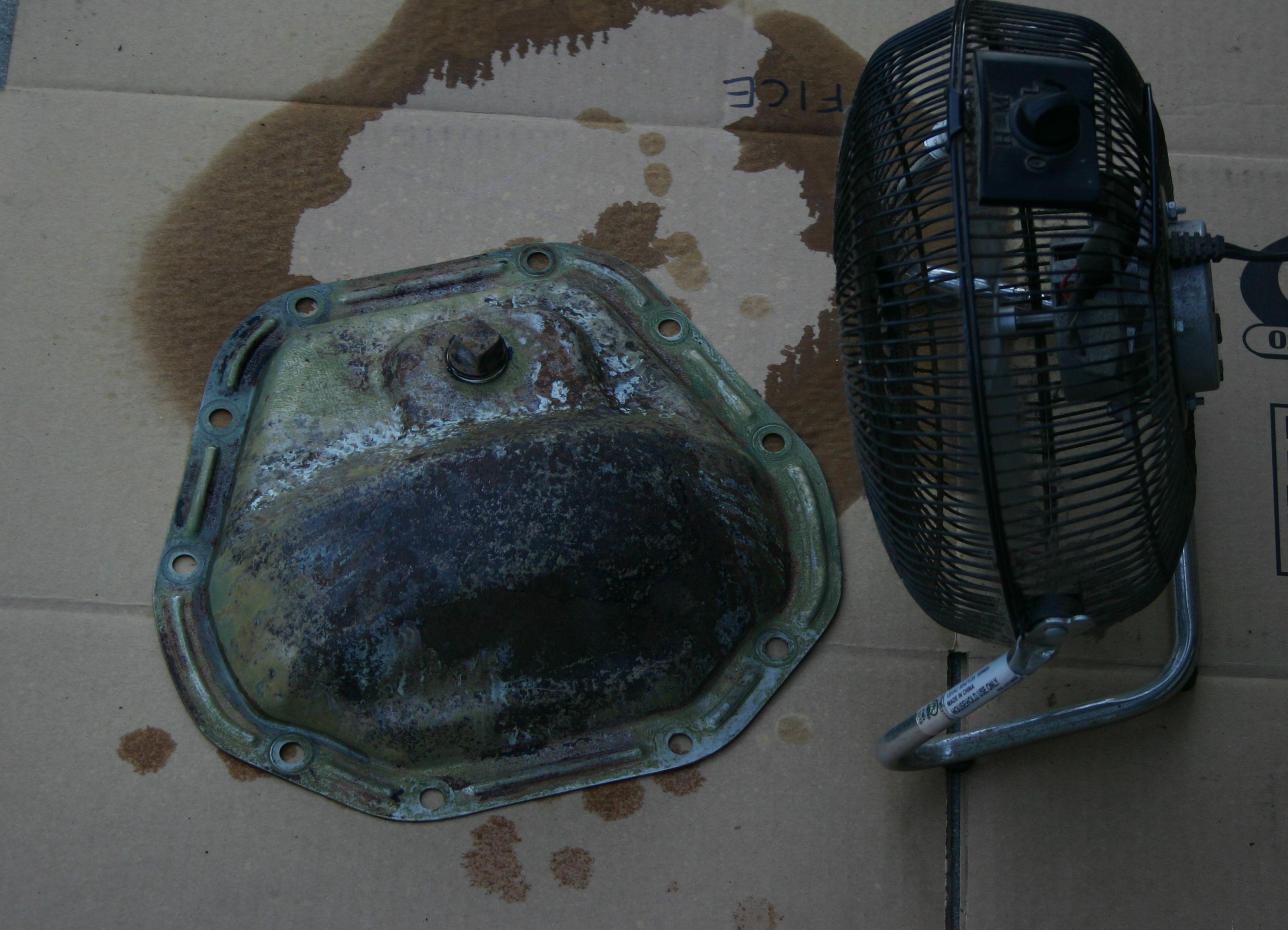

Today's Questions:
- Shall I install that gasket "dry," or use some black Permatex-like sealant on it?
- I'm guessing that using medium-strength, blue thread-lock would be a good idea for the cover bolts; might something else be a better choice?
