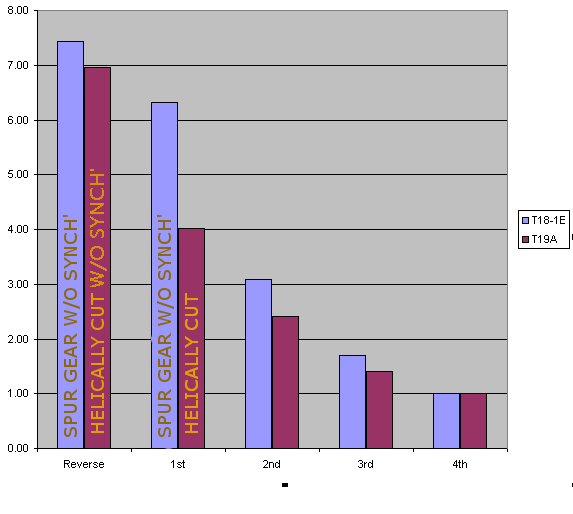

Here's a chart I made that shows the ratio differences between the T18-1E and T19a (the two I'm trying to choose between):
As you can see, the T19a has way taller gears, which would mean, for example:
  1. With a 5,000 RPM shift, I'd shift from third to high gear at 70MPH with the T18-1E, and 85MPH with the T19a.
  2. The T18-1E would see a 3,000 RPM drop between granny and second, which probably doesn't matter much since I'd rarely use that gear. The T19a would see a 2,000 RPM drop between granny and second.
  3. Both transmissions see a 2,000 RPM drop between second and third.
  4. The T18-1E sees a 2,000 RPM drop between third and high, while the T19a shows a 1,500 RPM drop here.
Given this ratio comparison, and given that my engine produces most of its power between 2,000 and 6,000 RPM, does the T19a look like a better choice?
