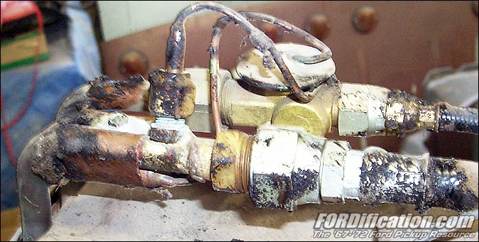

Well, it ain't the best pic, but it's the only one I have. This is the setup from a factory A/C...the suitcase style.
re: PLEASE HELP F250 Expansion Valve
keith to me thats the best pic in the world right now... that valve has two copper lines one for pressure and temp, right... if so where can i find the part number for that... i cant seem to find it anywhere!!!!!
keith is now the new webster... if he dont kno what it is nobody does...

I did a little more looking after Keith posted the picture and couldn't find one like that on the parts america web... This was the closest one I found and I don't think it is the same as it looks like it is missing the other small tube... http://cgi.ebay.com/ebaymotors/ws/eBayI ... %26fvi%3D1
Might try Ford Dealer but may have to rig up something different...

thanks ya'll i found it on old air propducts in texas $69 part number 25-8798

if you have a factory a/c you can get a new part #25-8798 (ford # c8tz-19849-a) from old air products in texas. if you have a dealer add-on there is no aftermarket part, the ford # is c8tz-1849-b
