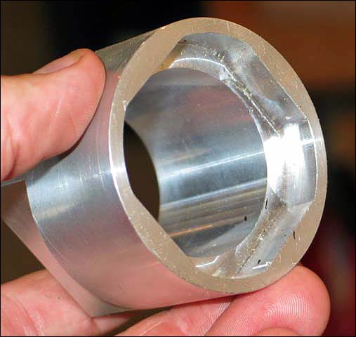

I have two of the sockets at work and we bought them from OTC ?? I will check and get the part number today. I have worked out the brake rod and brackets for mine, I'm using after market brackets. I tired some from dent side vacuum booster, holes didn't line up as well.

Ok I got the info 1 of our sockets was made in house, the other was purchased from Kent More tools #J-29192. doesn't look hard to make thou.
2 1/4" od pipe, with 1/4" thick 3 1/2" long. couple of pic's for your pleasure.
