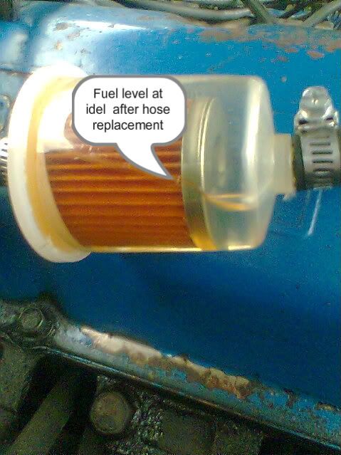

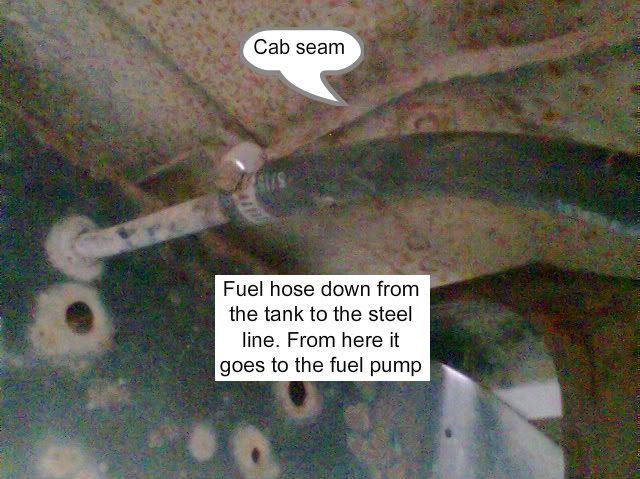

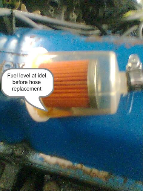

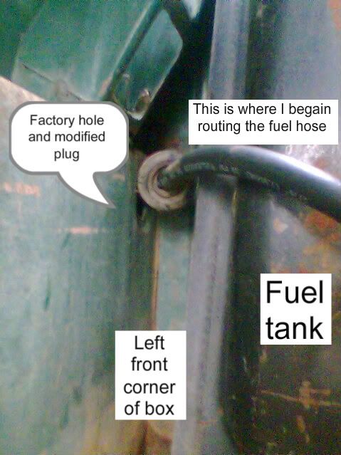

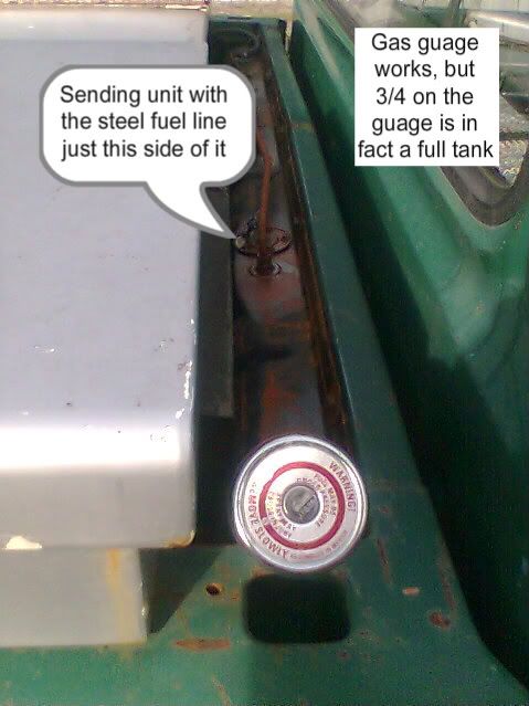

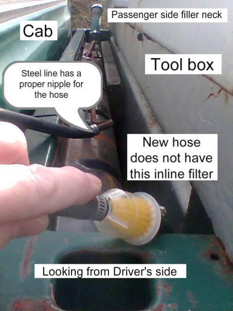

Well it worked out a whole lot better than I thought it would. The Lord was good to me dispite my doubts. First I ran the truck and got a pic of the inline fuel filter near the Carb ( an eye dropper or two in the filter ). And pics of the hose and tank as they where.
I'll got my big gas can filled and run the truck off that to see what would happen. The Carb see thru fuel filter, filled up about 1/2 and during high RPM and Revs it filled to 3/4 full or better. Replaced the 6 feet of fuel hose from the steel tank line to the other steel line that leads to the pump.
Thank the Lord it ran the same way as on the gas can!!!! Once I got to a place where I could blow the bugs out it....

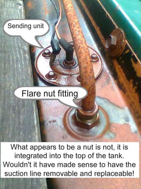

It began to run poorly toward the end of Feb 2010 and so was stuck trying to figure out why it had started running poorly again. Gas tank is in need of replacement. Ordered Feb 26 2011. The contaminants (rust particles) foul the pump and restrict the flow to the carb. This results in a fuel starvation problem and poor running. The fuel filter just before the carb keeps the trash out of the expensive Edlebrock carburator. Cleaning and re-sealing the tank are an option, but one has to have the time, patience and warm garage to do so… I kept the battery up and the engine started once and a while till I could re-new the registration and be satisfied that it would run well enough to get the trash (pilling up in the box) hauled away to the dump… Fuel level in the clear fuel filter is good (about ¾ full while running) so the problem with contamination is apparently intermittent. When restricted it shows up as a relatively low fuel level in the filter (about ¼ full while running) and of course in the poor running of the engine. Initially (by the PO) the filter was between the tank and the pump. Following new fuel pump install I added another filter between the pump and the carb. The result was a fuel starvation problem. Sooo I removed the filter between the tank and pump. With the single filter between the pump and carb, the flow and resultant psi is increased and the engine of course does much better… I wonder, is the pump so designed, that the suction side is simply less capable of drawing the fuel well enough through an in-line filter (other than the screen at the bottom of the tank) and then getting the fuel past the 2nd filter (just before the carb) with enough psi to keep the carb adequately supplied with fuel?
