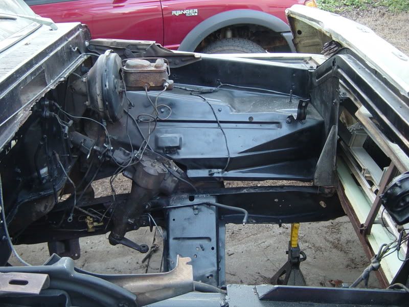

I have the booster, the push rod that pushes on the master cylinder is missing. Now the rod that hooks to the pedal is there.
Like when I took off the master cylider, there is nothing to push on the piston.
So what I have its
(master cylinder) {missing part} [Brake booster] (push rod that hooks to pedal)

Just to make sure everyone is on the same page as me...
If I remove the master cylinder (replaced the rusty one in the pic) what is suposed to actuate the piston in the cylinder that would be between that and the booster? That is what is missing.
If more pics are needed I will see what I can do.
Tim

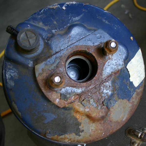

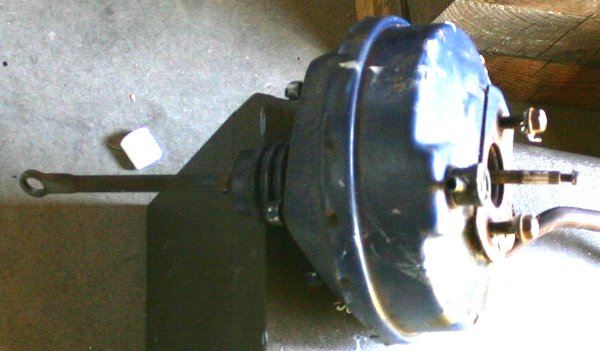

Here's the booster the pushrod came out of. It used to be installed on #50 (1972 F250 8,100lb GVW).
Here's the pushrod installed in the booster body.

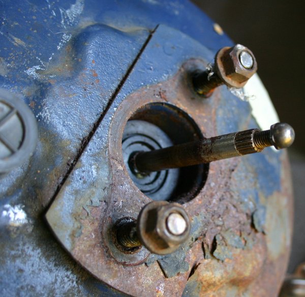

Here's the body after I yanked the pushrod out. It actually came out like it was built for that--I just had to give it a good pull!

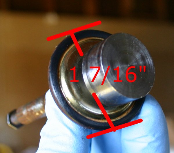

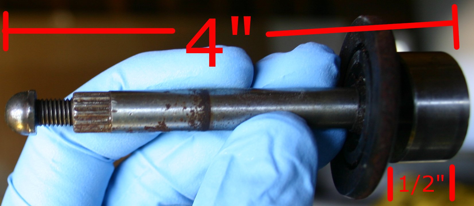

Here's the pushrod. I was surprised at its shape! The link under this small photo goes to a full resolution edition of the same photo. As you can see in the photo, the whole thing's about 4" long. Its circular base is around 1/2" long.
http://www.robroygregg.com/Number50/IMG_3610s.JPG
And the seal that's above the circular base is about 1 and 7/16" across.
Tim, if this is the part you've been looking for I'd be happy to send it to you. I don't have any use for it!
