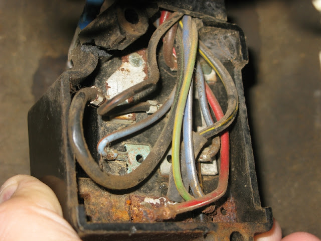

Here is the before and after for the fuse block.
Got all of them fused on the constant side (black w/yellow strip) except the heater and instrument lights. I will probably move the turn signals on the ACC side later on.
