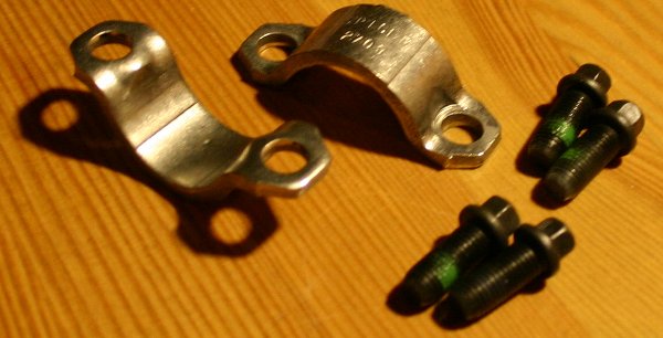

I'm now ready to torque the U-joint retention bolts, which are just like these ones:
The 1972 Ford Truck Shop Manual, on page 15-05-8, lists a torque value of 13-17 ft/lbs for these bolts. I suppose the bolts are very small but this torque still seems pretty light duty compared to what I'd expected. Isn't it true that these bolts are directly responsible for not shearing in the face of a significant portion of the engine's power?
Also, what are those funny green splats on the new bolts--are those built-in thread lock patches of some kind?
And would you use thread lock on these U-joint retention bolts or not?
Thanks very much for the wonderful advice!

robroy, the green spots on the bolts are Loctite or a similar threadlocker.
The bolts actually don't have a lot of stress on them. They simply hold the strap against the bearing cup. The stress is delivered directly to the pinion yoke.
Just tighten them down with a box-end wrench and it's "Happy Motoring"

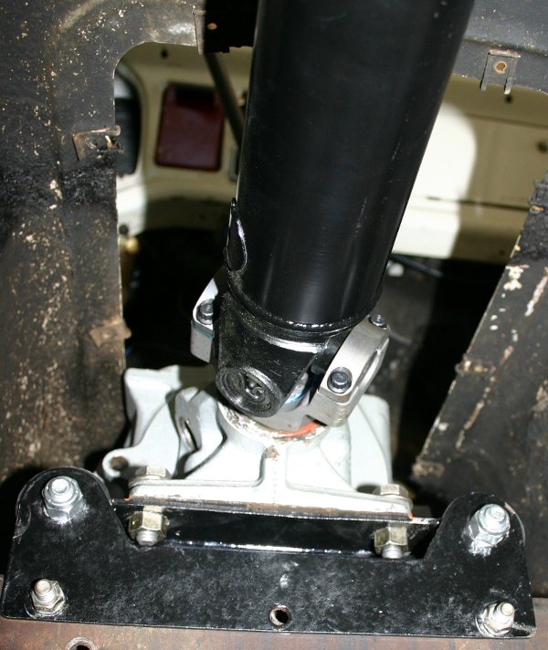

Re: Should U-joint retention bolts really be 13-17 ft/lbs?
Today I finished the drive shaft install! I guessed on the torque for the little bolts, as advised. I found that this wasn't really very hard to do, since the bolts seemed to have a pretty firm stop at the end of their travel--I just gave it a good shove after screwing them in all the way.
I also used some medium strength (blue) thread lock on the bolts that hold the T18 area together, since they didn't come with any funny thread lock patches stuck to them.
Thanks for the outstanding advice!
