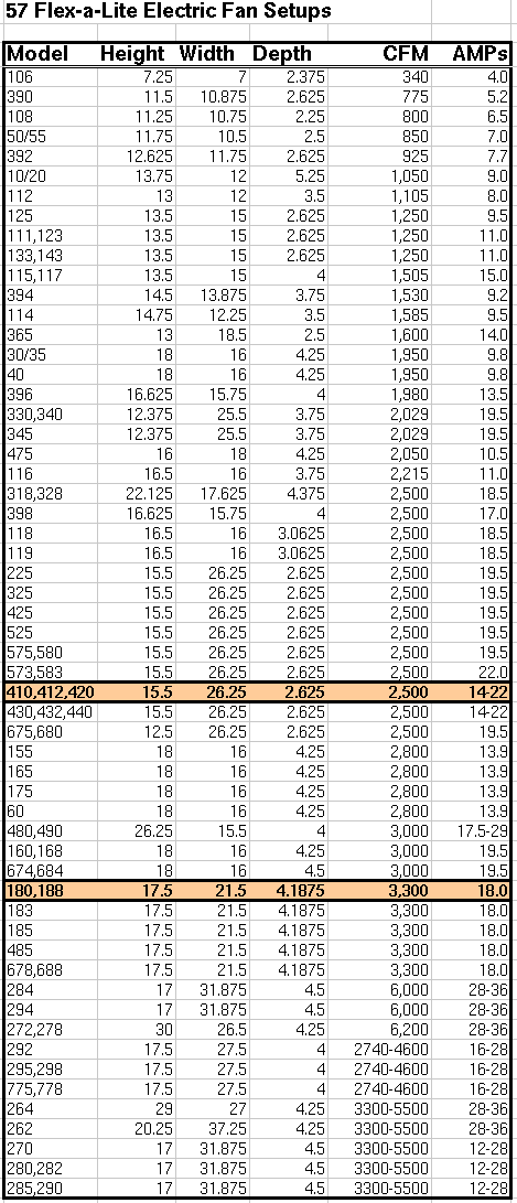

And so the deduction began! Here's a list of all 57 fans on the Flex-a-Lite Web site.
Note that in this table, I converted the fractions to decimals, making no effort to correct the artificial precision that's introduced by a straight fraction to decimal conversion. Of course Flex-a-Lite never implied the claim that their product measurements were accurate to a thousandth of an inch!
Also note that in all of these tables, the two fan models recommended for our trucks by the Flex-a-Lite Web site are peach-colored.
I'm making the inference that because Flex-a-Lite's Web site didn't recommend any setup with an air-moving capacity under 2,500 CFM, that they're recommending at least 2,500 CFM for our trucks. Maybe that's a foolish assumption but I had to start somewhere!

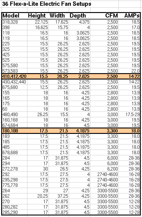

Based on a minimum capacity of 2,500 CFM, I reduced the candidates to from 57 to 36.
Next, I removed all the application-specific fan models, such as fans made to fit Toyotas or Dodges. I'm assuming that those models wouldn't be good choice for our trucks, since they come with hardware customized specifically for these other vehicle bodies.

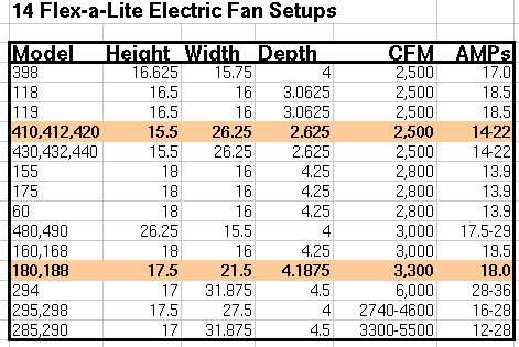

Showing only universal-fit models, the number of candidates was reduced from 36 to 14.

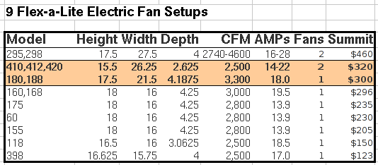

Next I removed the fans from the list that push air, since I'm only interested in a "puller." I also removed the fans that were obviously much too large for my radiator size.
This reduced the list from 14 to 9. And to this list, I added columns with the current Summit prices, and the number of fans in the models.
So there are nine Flex-a-Lites left to choose between! Or, if I insist on having dual fans, there are two to choose between. That narrows it down quite a bit!
Next, I'll call Flex-a-Lite and chat with them on the phone about these different fans. I want to make sure that they're all USA-made, since I'll be able to remove any that aren't USA-made from the list.
