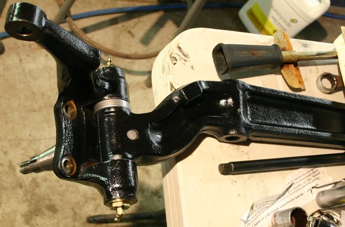

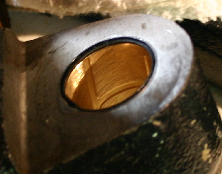

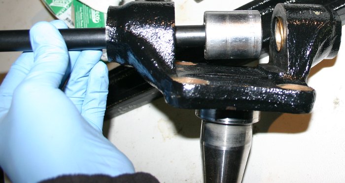

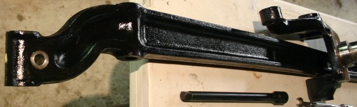

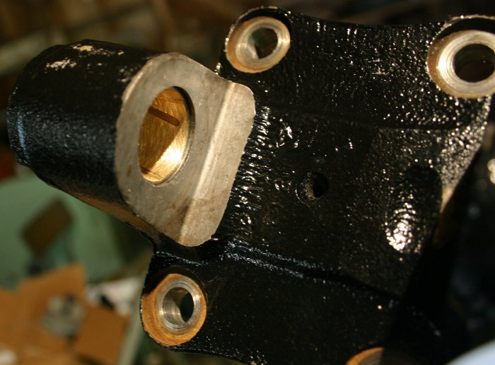

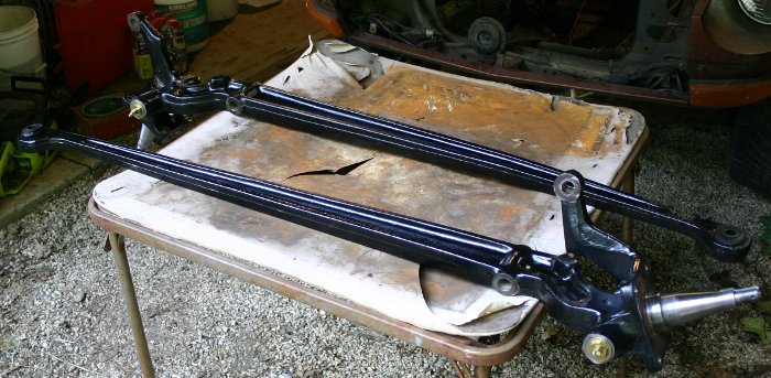

Today I finally reached 100% on #50's I-beams/spindles/kingpins and bolted them to the frame! The spindles and beams were sandblasted, then coated with Rust Bullet, then coated with Black Shell. The spindles had new bushings pressed in, and the kingpins/bearings/seals/etc are all nice and new.
They sure feel good when you steer 'em back and forth!
Before tapping the seal in:

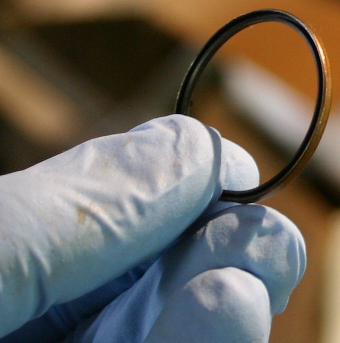

Here's the seal:
And my arrangement for tapping it in:
Got it!

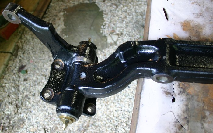

The finished products waiting for installation:

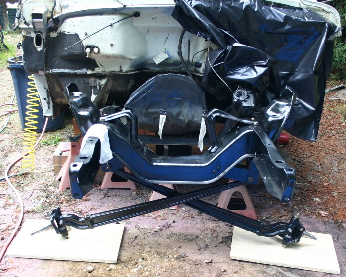

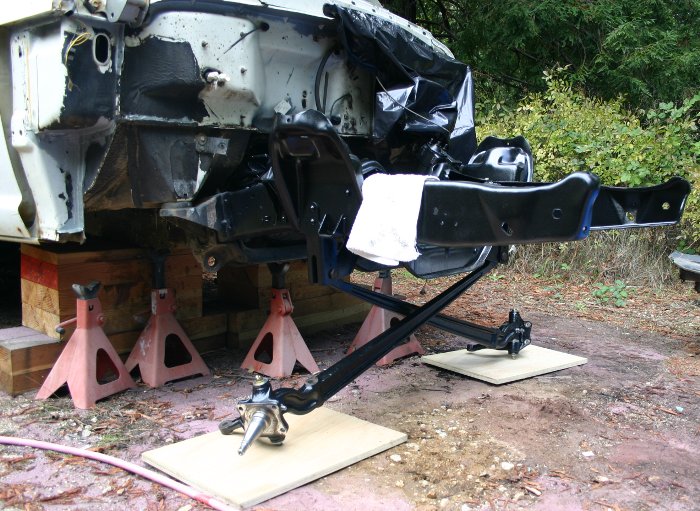

Just installed! It's sure nice to see something going back in instead of coming apart for once.

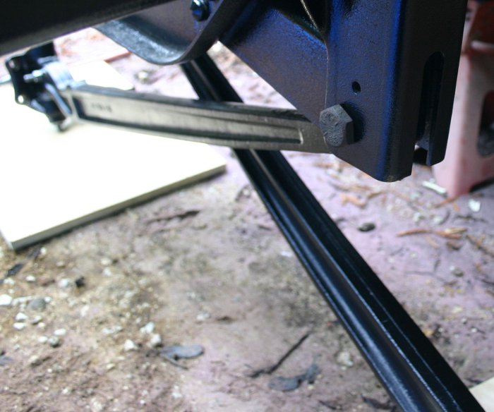

Notice that I'm lazy and didn't refinish the bolts that hold the bad boys in!

Finally someone who knows how to take pictures. Looks great for sure. I'm about to be sand blasting my frame in the next month or so. Then I will be doing king pins like you. I can see you went with the metal bushings. Did you reem them yourself or have it done?

Yes, I went with the metal bushings, but not by choice; I wasn't aware of any other option. I used a kingpin kit from Napa, and it was their high end kit. They also had a low end kit that was made offshore. I could get a part number for the kit I used if you're interested.
I had a machine shop install and ream the bushings.
Austin, something you may benefit from knowing is that it's common for the bearings in those kingpin kits to feel a little raw and gritty, like there's metal to metal contact happening inside of them--they don't feel as smooth as a wheel bearing. Another chap on this site and I compared notes and agreed that that's the way they're supposed to be. He even went back to the auto parts several times to swap out his kit, thinking he had bad bearings, and they were all that way!
This said, it does seem prudent to wash the bearings out with solvent (to wash any dust particles) and try your best to pack them with grease before installation. Even the 1971 factory service manual says to pack them before installation, even though they're supposed to get their grease from the nearby grease fitting.

I have a hunch that the seal is only there on some models, and I believe the kingpin kit is different for trucks with different GVW ratings. Mine's the 8,100lb rating, which has a different kit than the standard F250 rating. I'd have to look through the factory chassis manual again to confirm this.
I don't understand exactly why the seal is there, but it seems to keep two zones of grease--one at the top and one at the bottom (where the bearing is).
By the way, I actually put mine together the first time without the seal! I pulled it all apart after figuring out what was going on and re-did it.
